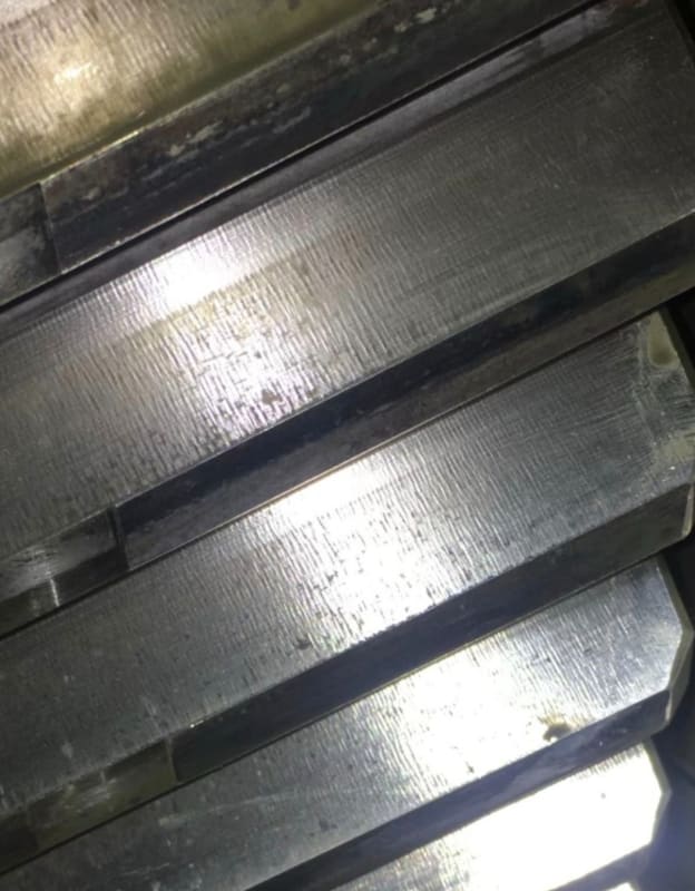

Jan 12, 2022 #1 NJAus1 Mining Joined Mar 19, 2019 Messages 23 Location AU Hi All, I was wondering if I could get some feedback on the surface finish of gears as shown in the photo below? The gears are new and are carburized. I am unsure what would cause this unusual surface effect? the gear in question is on the left. Thanks

Jan 12, 2022 #2 TugboatEng Marine/Ocean Joined Nov 1, 2015 Messages 12,106 Location US I don't see anything unusual. The wavy pattern is polishing of the high spots but I see no corrective pitting or unusual wear. As the gear wears in you'll likely see the surface polish become more even. Upvote 0 Downvote

Jan 12, 2022 Thread starter #3 NJAus1 Mining Joined Mar 19, 2019 Messages 23 Location AU This is a close up view, is this considered normal on gears as a factory finish? Upvote 0 Downvote
Jan 12, 2022 #4 mfgenggear Aerospace Joined Jan 23, 2008 Messages 3,611 Location US Please advise #Teeth, Diametral pitch, pressure angle, and AGMA grade, & surface finish required use a portable profilometer and take a measurement Upvote 0 Downvote
