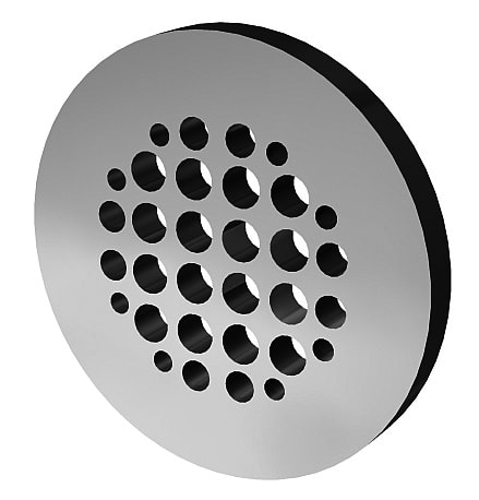

If you want to try something then maybe insert a flow conditioner plate between the faces of the flange - like this
Perhaps it is occurring because of a quick startup or shutdown. How long are the filter runs?
LittleInch, not being shy regarding the flowrate. I asked the client to provide. Still waiting for an answer. I was thinking about straightening vanes, but the perforated flow conditioner is a great idea. Thanks.
