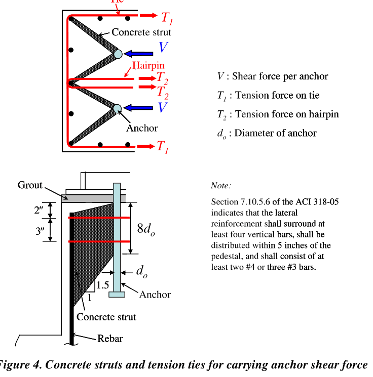

My assumption is that the anchor rods themselves are adequate to transfer shear from the base plate to the concrete, since they are typically sized by the PEMB engineer for the loads. So really the capacity that needs to be increased is the concrete breakout capacity, correct? The concrete breakout capacity is basically the same regardless of shear load delivered through the anchor shanks or delivered through that angle. So that's why I was suggesting anchor reinforcement to restrain that breakout cone and achieve a higher overall capacity.
My general approach for PEMB is to add supplementary reinforcement at the anchors. They typically like to use bypass girts and lap the siding down the edge of the foundation which forces you to ~ 1 ft edge distances to your column centerline. CSA published a guide called Design of Anchor Reinforcement in Concrete Pedestals that is helpful, snip below.

I just think the PEMB engineer has a fundamental misunderstanding of anchorage if they suggested the angle to increase the anchor capacity. If the concrete breakout capacity is deficient for the shear load, then it doesn't matter what mechanism is delivering the shear load to that concrete breakout cone. The angle doesn't do anything to restrain the breakout cone, so it's pretty useless IMO.

This is just my opinion, but if the breakout capacity is deficient using the anchor group pattern, but sufficient with a shear plate that is only 3” or so wider than the anchor spacing, then I wouldn’t be comfortable with that safety margin. Using reinforcement to restrain the breakout cone has almost become the standard of care at this point in time, and I think that is the best practice. If you have a concrete pier, the ties are going to be there anyways. It’s just a matter of quantifying their capacity as anchor reinforcement using the method GC_Hopi references. I know I may be a bit of an anchorage snob, but I don’t like to mess around when it comes to PEMBs.

So my approach will be to figure reinforcement to restrain concrete breakout.
