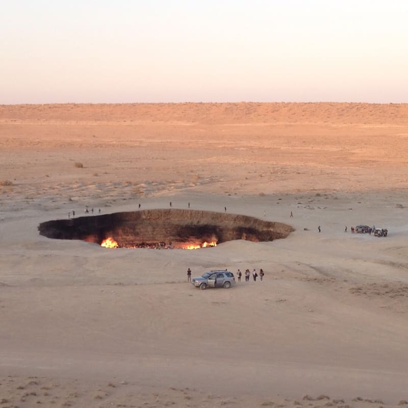

Stopping the fire will save CO2 emissions at the cost of releasing methane(CH4)... a worse greenhouse gas. I don't know what the solution(s) is.
It might be done with a dome over the 250 foot span to choke off the flow of oxygen and capture the flow of gas, but it's in a place where building that is a problem. One might manage to use a fabric structure over a frame if a suitable blanketing gas could be used instead of suffocation to cut the production of heat; perhaps the heat released isn't enough to damage a high-temp resistant fabric before it goes out. Once extinguished the gas can be captured in the dome, compressed and sold. I've seen the military use of pressurized bladders to support large tent structures; perhaps that could be used and avoid needing to built metal frames. It doesn't need to have a high arch to it, unlike stadium domes there's no crowd or sportsball needing clearance.
Access and price are the real limitations on this. I think the technology to do this isn't out of reach. The politics might be out of reach and the ROI is not promising. It's not as if money isn't available, but it depends on the willingness to do so: This article say 19 foot (I only count 4) which I expect is how tall it is, rather than nose to tail??

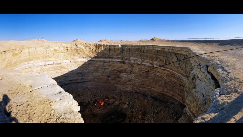

Nuclear detonations are banned at the surface. So, they'll need to bury it deep enough under the crater to meet those restrictions. The explosion will probably create the largest fireball mankind has ever seen. Then there will be smoking chunks of sand and rock raining down on ... the vacant desert, for miles around. It could also fracture the underlying rock into the main body of that gas deposit, and we'll have a new land of the midnight sun.
On a more serious note, how do you choke off the oxygen that is available in the surrounding soils? Deep sheet [bigsmile] piling, all the way around the crater?

It isn't necessary to choke oxygen out of the soil - I think the overlying surface was impermeable to the methane, which allowed it to accumulate in the first place. Then someone made a hole in that cover and it's gone downhill from there. It's clear the gas isn't mixed with oxygen before it escapes from the sand. Otherwise the flame front would be tight to the surface.
I'm not familiar with the site soils, so cannot address how much subsurface oxygen is available. That was the basis of my question. I presume it's a sandy soil, with low moisture, and therefore has a fair amount of air in the void space.
I will be interested in seeing how they plan to cap a 70-meter wide opening in the ground surface and try to extinguish the flames. I'm sure a number of people have contemplated it over the last 65+years

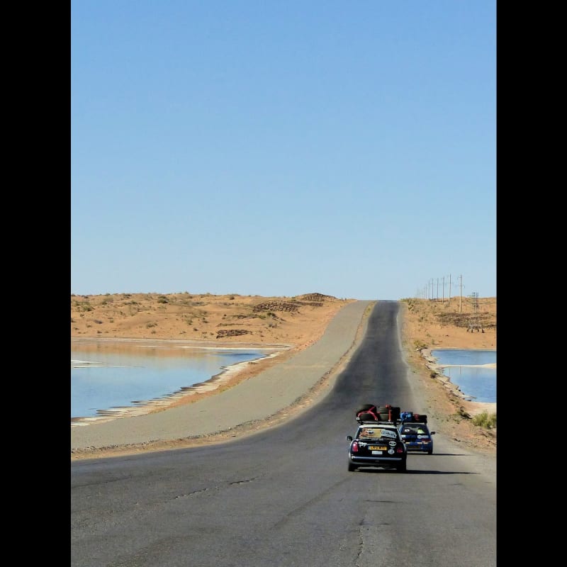

It is interesting to look at the google earth image as there is quite a lot of strange excavation around the site. There is also an image along the nearby road with a mini cooper showing some water impoundments as well as a second crater near the gates of hell crater:
Subsurface natural O2 is only found within a few meters of the surface. A lot of O2 is needed to support continued combustion and it is simply not available underground. As far as I know, free O2, if found in a well gas streams, is the result of pumping it into the well casing, having been drawn in from atmosphere sources.
The object of an explosion should be to collapse the faults and fissures supplying the gas from the underground reservoirs below. If the reservoir is close to the surface, that may preclude pinching off the supply and instead, possibly exposing more of the reservoir, thereby increasing the gas flow to the surface. The geology of the site may not be conducive to nuking.
