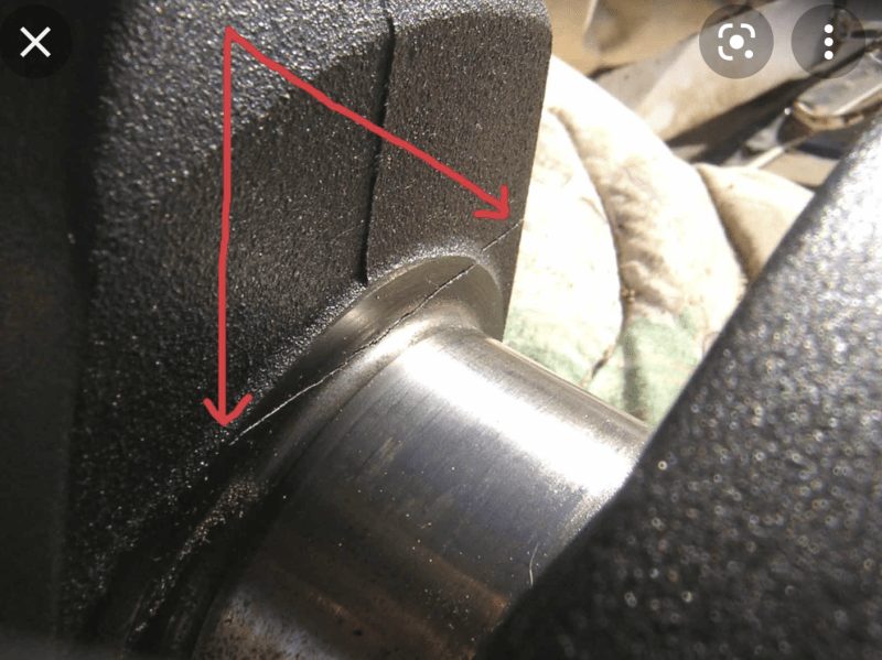

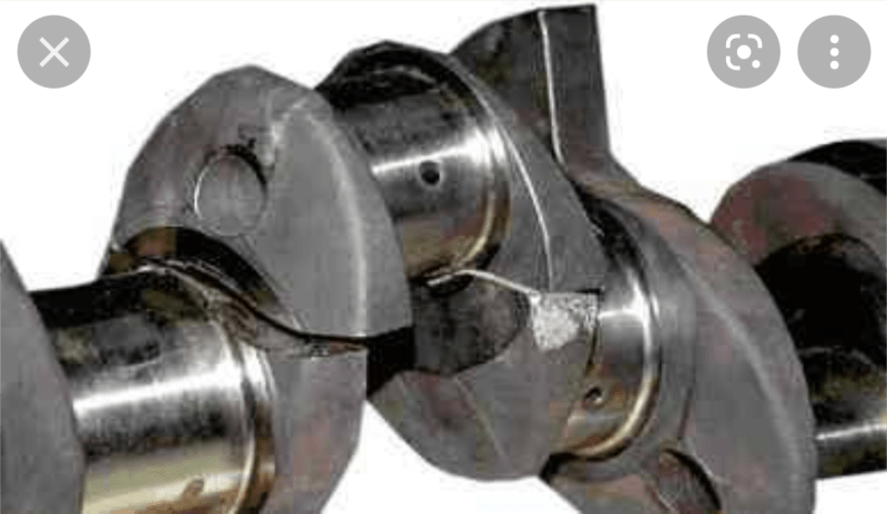

A crank breaking anywhere but in the journal fillets is interesting. What appears to be a flame cut surfaces is also curious.
I'll try to watch the video at home to see what's up.
Certainly in the link the alignment of journal's halves and the relative clocking of the front and rear throws is checked diligently and adjusted many times.
I did not see any clocking checks made after welding, but the presswork required to straighten the welded crank rlative to the adjacent journals is what I'd expect from any welded component.
Similarly the straightness after removing so much weld metal should not be ignored.
A quick Google of broken crankshaft pictures shows the break typically starts at the journal radius and proceeds through the web.
Some examples stolen from the web:
