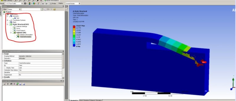

I'm trying to run a fairly simple simulation and getting nowhere with it.
I'm simulating compression of a cantilever tab until it hits a stop. After that it should go into sliding support against that stop and 2-point supported beam deformation.
I'm probably not using right solver and/or constraint.
Seems like such a simple problem. Infuriating.

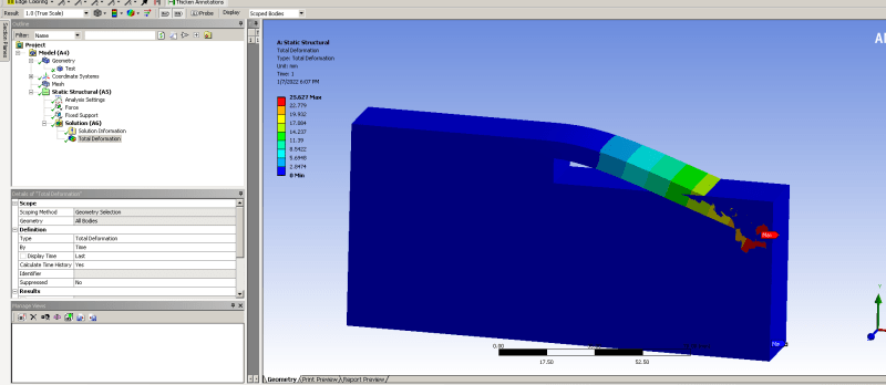

Did you define contact ? How does it looks like with the deformation scale factor set to 1 (true scale) ?
It's true scale. Simulation doesn't understand there is another surface.
You have not told the software to detect the presence of another surface/entity i.e., you need to prescribe contact (constraint; thou shall not pass!) condition between the two entities. Also, you are supposed to perform a nonlinear analysis.
I would recommend taking a step back and running a Hertzian contact analysis. Compare analytical predictions against numerical ones. Finally, find a gray haired mentor, if possible.

I do not see any connections inserted under the model tree which is nothing but no contact defined.
Model=>insert connections=>insert contact => frictional or frictionless=>define the cantilever tab as slave(less stiffness part) and stop surface as master (higher stiffness part)
