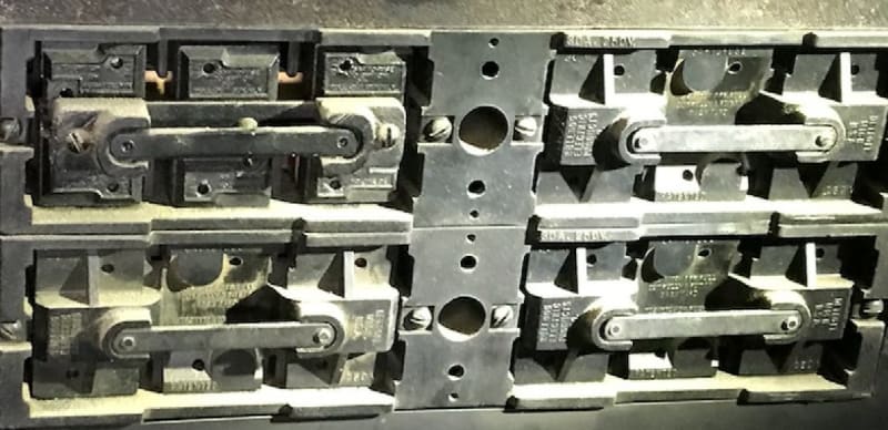

Yeah yeah I got the fuse at the top than can be repaired with a penny..
Those things at the bottom?
This panel is controlling a 240V water heater... with the one screw in fuse.
Keith Cress
kcress -
I believe those are all branch circuit fuses. The screw-in is not for your water heater. I have a somewhat similar panel in a house that was electrified in the '50's. The larger capacity circuits used pull out fuse holders that contained cartridge fuses, which look somewhat like those in your picture. My panel does have a main fuse but it is separate component mounted at the top of the panel. Your main fuse may be in another panel.
Brings back memories. The horizontal bars are the grab handles for giving enough grip to yank those out. I had a neighbor one time ask if I knew how to repair a cartridge fuse. Thanks to blue laws and it being Sunday night, not a store was open; not a good thing when the A/C no longer works. My (then) new house had been changed to a breaker panel, so no fuses remained.
Yep. Pull out fuse holders. The retractable handles pull out so that you can grip them, then you can yank the entire assembly out, which is holding the cartridge fuses. It has a secondary function as the disconnect. I've seen those before in old old buildings. General Switch maybe? Bulldog? I can't remember any more.
AHhh yes.. That's making sense now! Creepy that there's bare metal on those yank-outs.

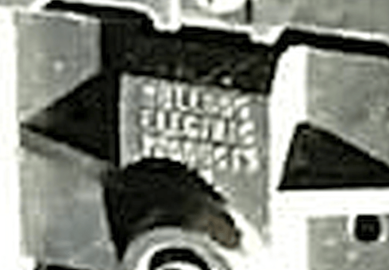

If my eyes were really sharp, I'd be able to see more than "??LL??? ELECTRIC PRODUCTS"
The material looks like Bakelite, so any handle made from it might snap off, although I did see a couple of examples where it looks like a pull handle is Bakelite.
TTFN (ta ta for now)
I think it might say Bulldog Electric Products on one end and Detroit Mich USA on the other end
Definitely says "Bulldog", who went on to become ITE/Imperial, then ITE/Gould, then ITE/Siemens, then just Siemens. The "Bulldog" name was dropped in the late 70s I believe when Siemens bought them and already had a competing line of disconnects and fused pullouts (the other "Bulldog" products were "Pushmatic circuit breakers, which Siemens kept but later discontinued too). Most of the Bulldog pull-out switches I encountered were from the 50s and 60s, they all had a steel "D Ring" handle. Those are likely older, maybe 30s or 40s? Might be time to replace that stuff, parts will be unobtanium.
