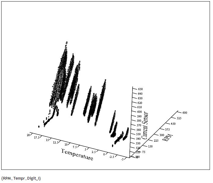

Well now that it works, here's what I wanted to do. Knowing the trick and I did get the thing plotted in 10 minutes like I wanted to.
The plot compares the measurement from a current sensor in various conditions. The current produced by the generator should be zero up to a certain speed threshold, then increase linearly at higher speeds. At different temperatures the sensor's sensitivity seems to change, but I wasn't sure. I wanted to spend 10 minutes exporting the data table from Excel to Mathcad and plot the 3d scatter to see it. Little did I expect it to take 2 hours doing consistently the wrong thing in MC. Which is about as long as it would have taken to do it normally in Excel but hey I'm still a MC fan despite its quirks.
Visualizing the data made it clear that the trends are hard to see in the hash of values from the current sensor. That in itself is annoying, and could be a good reason to choose a different sensor for this job. There may also be too much noise from something else in the system. I didn't even think of it at the time, but now I want to add at least a capacitor from Vcc to Ground on the sensor to see if that helps.
A surface plot might be more apropos. Nevertheless, the trends appear to partially support your statements, but the bigger issue is that the data doesn't appear to cover the threshold conditions particularly well in some cases, or not at all, and in other cases, it doesn't cover the current rise vs. rpm slope regime. Note that copper resistivity is temperature dependent, so some variation with temperature would be expected, even if the sensor was thermally stable.
