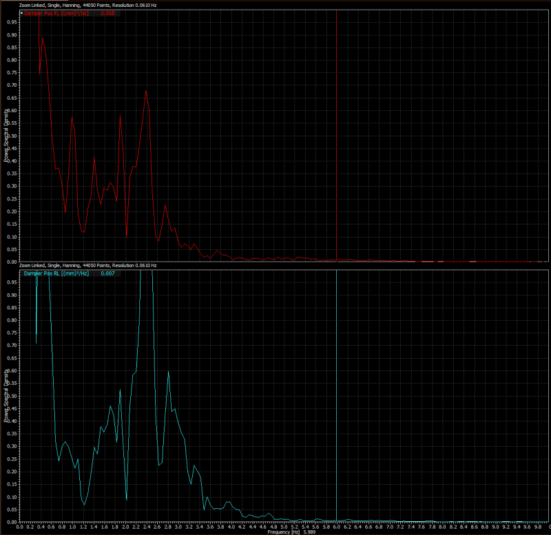

Kovalczyk in his SAE paper writes "First the downforce levels are determined for a given cornering scenario. Then the wheelpan input amplitude is varied until the power spectral density (PSD) of the damper displacement signals is similar to what is seen on the track." I thought that I will simply compare Motec/FFT PSD plots to Adams dal_ride_damper_data.displacement FFT PSD. I used -25/25mm sins weep from 0 to 20Hz and -10/10mm amplitude. but it turned out that numbers from Adams and Motec are very different.
APost dal_ride_damper_data.displacement FFT PSD -10/10mm displacement 0 to 20Hz
Motec/I2 FL damper displacement FFT PSD
I'm confused and not sure if I'm comparing apples to apples. There's a feeling that may be software programs calculate FFT a bit differently and Motec data is like APost * 0.1 Any suggestions on the way to properly compare logged data/Aride data and developing a way to create representative input would be extremely helpful.

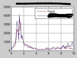

The correlation can be very good, for instance here's an overlay of the fft of real data from the track and ADAMS, for vertical vibration

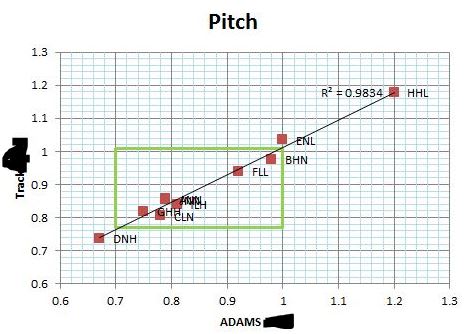

and here's the results of testing for pitch for one vehicle in many configurations (basically a swing on damper settings at each end). These are the RMS values for a filtered spectrum-all ride work is filtered for analysis.
Bear in mind getting correlation like this initially took two of us (one on the car, me on ADAMS) several weeks, at least for me.
