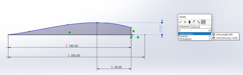

edit....btw not to discount your opinion on the lack of need for the dropdown, but it is damn nice to be able to type in C and get all Chord values I've created, or just scroll down to global variables and get everything at a click. I'm not pumping sw here, I'm just saying the auto-populate variable/parametere/equation whatever a software calls it is a damn nice feature.

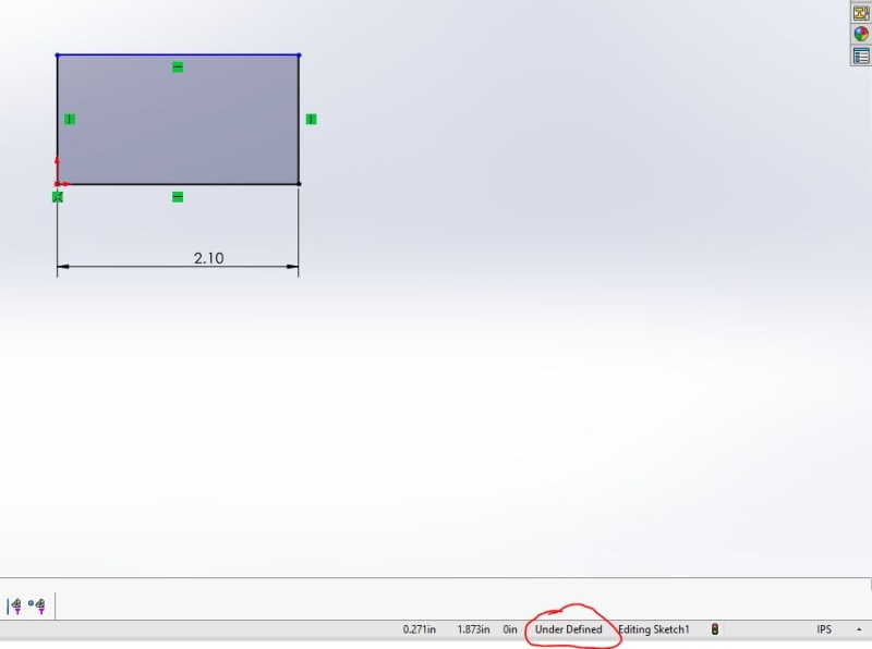

I don't know what you mean about SW enforcing fully constraints...you are at liberty to completely underdefine your work, but that's at your own peril. Here is SW warning at the bottom that you are underdefined.

I think the constrained issue is a grey area and is perspective. I'd argue hard against the creo approach, here is why...So a fully strong sketch in creo is deemed fully constrained. So is a fully weak sketch. If I go into another software and fully dimension a sketch then delete all sketches, what do I then have? I have a 100% desired sketch to spec, yet completely unstable and more importantly unreliable. I'm no expert, but when you can't move points on a sketch manually, I deem it 98% constrained. The other 2% confuses me, don't ask.

Yeah - that cannot happen in Creo. There are no underdefined sketches.
Edit:
Constraint as in - the geometry solver has all the equations required to produce a single result. Not - cannot be modified by further user interaction.
