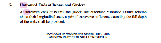

AISC 360-10 J10.7. Unframed Ends of Beams and Girders said:
At unframed ends of beams and girders not otherwise restrained against rotation about their longitudinal axes, a pair of transverse stiffeners, extending the full depth of the web, shall be provided.
It's not just the top flange being restrained laterally, it's the entire section being restrained torsionally.
I'm not sure how to interpret the requirement cited by phamENG. If the top flange is deemed to be laterally braced, and if the bottom flange is bolted to the wall, then, it seems to me that the beam is restrained against rotation at the point of bearing.
Perhaps the correct interpretation is that if the top flange is completely unrestrained against rotation, a pair of stiffeners is required; in which case the attachment to the wall must be capable of providing rotational restraint.
