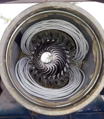

Dear all,
It is well known the skewed rotor bars in induction motors are used for avoiding CUSP, cogging and noise in three-phase induction motors. However, there is also the possibility of skewed slots in the stator. One of my collegues came to me looking for explantions of skewd slots in a 4160 V 5 MVA 4 Pole Synchronous AC Generator.
Does anyone knows for what were intended such skewed slots (all 60 slots are skewed)in the stator?
Thanks and Happy holidays!!
Petronila

Skewing of slots (stator or rotor) is primarily a means of reducing space harmonics associated with slot (or bar) passing frequencies. For larger machine designs - in particular synchronous machines with low pole count - skewing the stator slot is the preferred approach.
The skew does not have to be all one way, either. It could look like a herringbone pattern.
Converting energy to motion for more than half a century

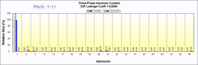

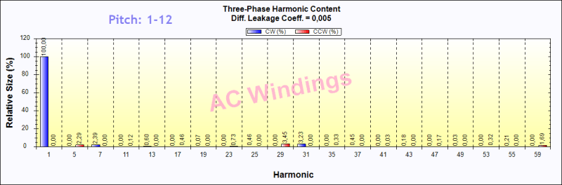

The skewing of the rotor bars or stator-slots can be done in several ways. Even like this:
The aim is to reduce step harmonics (order: k * slots +/- pole pairs; k is 1,2,3...) and thus prevent or reduce some side effects such as cogging, cusp and electrical noise, as these phenomena cannot be sufficiently reduced by any winding intervention (the pitch, connection, grouping, parallel paths, etc.).
Changing the pitch from 1-11 to 1-12 alone, can reduce the overall content of harmful harmonics but cannot reduce step-harmonics.
The harmonic content of equivalent winding (30 slots, 2 poles) for pitch 1-11 and 1-12 is shown below.
