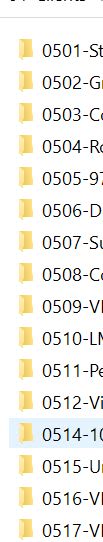

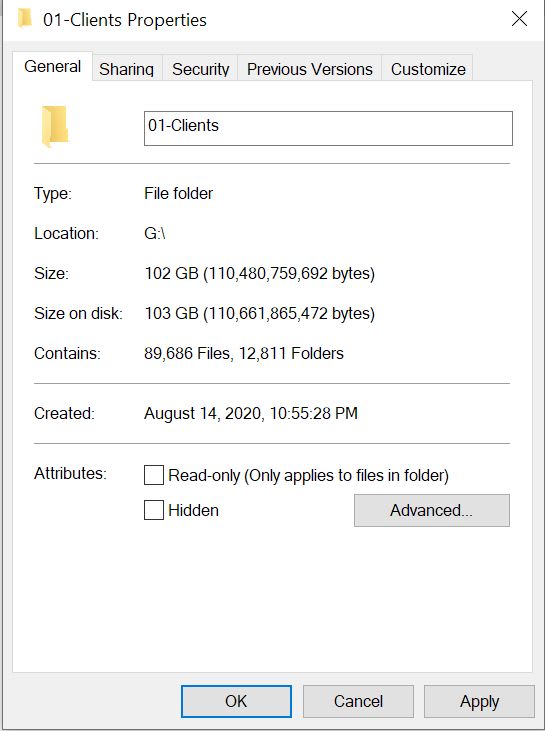

I back up each part of the work I do to a USB stick, as it's done. At the end of the day, I use a program called FreeFileSync to copy the days work to my two portable drives, and remove the ASUS Arion M.2 PCIe NVMe SSD and put it in the 'fire safe'. Done like a 'turkey'.

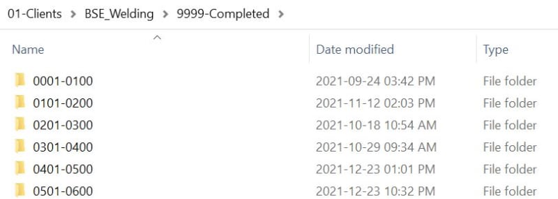

For my one client, I have over 570 projects and the completed projects are in a separate sub directory,and these are further separated into groups of 100 projects.
with the individual folders in these sub-directories (image cropped so project name not shown).
