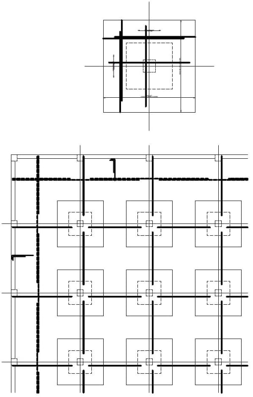

I've read more than a few texts on 2-way slabs. Most of them just closely follow code and therefore focus on the direct design method as well as the equivalent frame method (if I recall correctly?). What most texts tend to lack is any info about how to detail the slabs themselves, aside from recommended bar cut-offs. And they are especially lacking in methods of detailing more eccentric slabs. Very few authors want to touch it. I'm sure there's been a grad student (or two) who's a bit braver? Is what I'm seeking actually covered in ACI 318? And if so what's the oldest (and therefore least expensive ;-) ) edition of 318 that would have everything pertaining to 2-way slabs?

I haven't seen that many texts that take on the subject either. (At least beyond what ACI says on the subject.) It's not anything magic though....just a matter of a good model. In that regard, the slab not being sufficiently meshed in the FEA model is a frequent problem I see. I also see the "bouncy" issue as well.
Less steel and less bouncy means thicker slabs. No mystery. Maybe seismic design requirements are what changed. Going back far enough, dead weight only acted vertically so was easier to deal with.
What detailing info do you think is missing? If it's bar layout at odd-shape edges, no textbook or code will cover that. There are too many possible shapes for general rules to apply.
What do you mean by slabs not failing due to bottom steel? That's the point of reinforcement. Thinner slabs need more reo.

As mentioned previously, thinner slabs means more reinforcement (all other things being equal). In this scenario, the thickness game usually wins out. If you are building a 75+ storey tower and can take of 50mm from your typical slab you can fit an extra full floor on top while keeping the same building volume envelope! SO you may be fighting an up-hill battle if it comes to thickness vs. congestion of reinforcement (although thickness vs performance is another story, if the slab is not performing in a satisfactory manner this is obviously a big no-no).
If you want to keep a Structural Engineer honest and make sure there is not too much reinforcement in your slab, you can do a quick volume take off. Its surprising how a well detailed and designed slab fits within general guidelines of reinforcement tonnage. As a general rule of thumb...
- Two-way flat slabs have reinforcement tonnage in the order of 80-100 kg/m3
- Two-way flat plate slabs have reinforcement tonnage in the order of 120-140 kg/m3
If your slab is 10-20% above the upper bound of these limits, something may be over-designed.

I've never seen any good papers on more eccentric slabs (or recommended detailing practices in general). I have (and have used in the past) the reinforcing detailing manuals used by the trades.
And I've also seen lots of design examples throughout the U.S. and Canada, but most of those tend to be more 'square' shaped and get away with very conventional reinforcing layouts. I can say with confidence that designs outside my local area are far more rational than within. But as mentioned, those building layouts tend to be more forgiving to a rookie designer. Perhaps the architects in my city are simply making their buildings impossible to design?
For the small stuff I do, and the bigger stuff I did, I nearly always stagger rebars, often carrying bottom reinforcing thrugh the support as shown:
