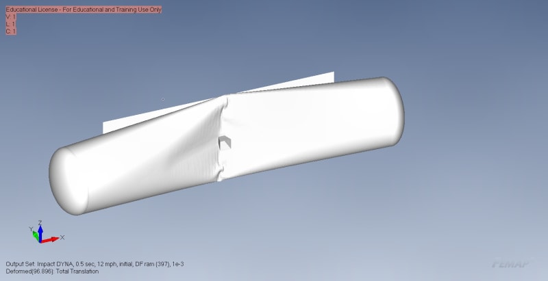

This is my results at 0.5 sec. It looks good. Pretty close to what I am trying to replicate. But that analysis had max ram displacement at 0.35 sec. After than the ram rebounded a bit. Mine keeps going even up to 1 sec at which point the tank cylinder is extremely deformed!

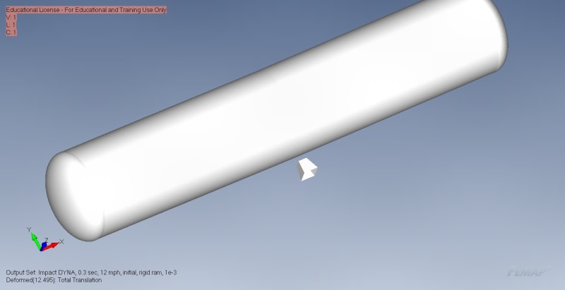

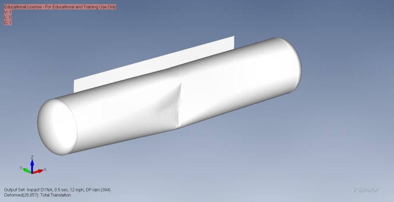

This is my plot with initial velocity. The ram appears to rebound after barely touching the tank. Now if I could merge the 1st plot deformation with 2nd plot rebound I would be on track.
This is my plot @ 0.5 sec with initial velocity. Now the ram doesn't rebound as above. But deformation looks right.
"This is my plot with initial velocity. The ram appears to rebound after barely touching the tank." ... that sounds like a rigid tank ?
all you changed between your two pictures is the time ? that's odd ??
