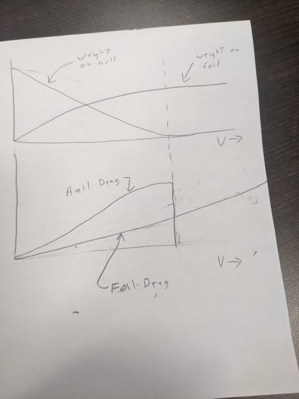

I have a well performing cruising catamaran, the water flow at the stern is flowing up the hull profile and is coming up at 7.5* to the waterline and I have been trying to figure out if I can claim something back by placing a hydrofoil in that angled water flow to produce some meaningful forward thrust.

I don't think you can generate thrust, but you can generate lift. whether it's worth the extra drag is another question.

yes, but the foils can create lift to offset some of the weight/displacement.
But not for free. Making lift makes drag.
Until you change the regime and transition to a hydrofoil Newton dictates that it is a losing proposition.
which I commented on ... "whether it's worth the extra drag is another question".
I agree with you that it's probably a losing proposition. I wonder if you'd lose even the small lift from the hulls.
I'm assuming something like this:
I'd have more of a "pop" as the hulls break clear. They seem to work that way, needing some extra drive to break maybe the surface tension ?
