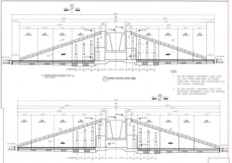

On the old ~1990 plans.... the walls are 48" thick at the bottom; and the footing is also 48" thick. For the main tension bars, they have #11 bars at 7" spacing.
When I first started the project, I attempted to recycle the design; but I couldn't get the numbers to work. I couldn't get the design to work unless I dropped the lateral earth pressures down to something in the 40 or 50 pcf region. My geotech report has equivalent lateral earth values approaching 80pcf if fully saturated.
I abandoned their design and came up with my own counterfort design. I still have a 48" thick footing, but my wall thickness is cut down to 30" (the shear is the killer).

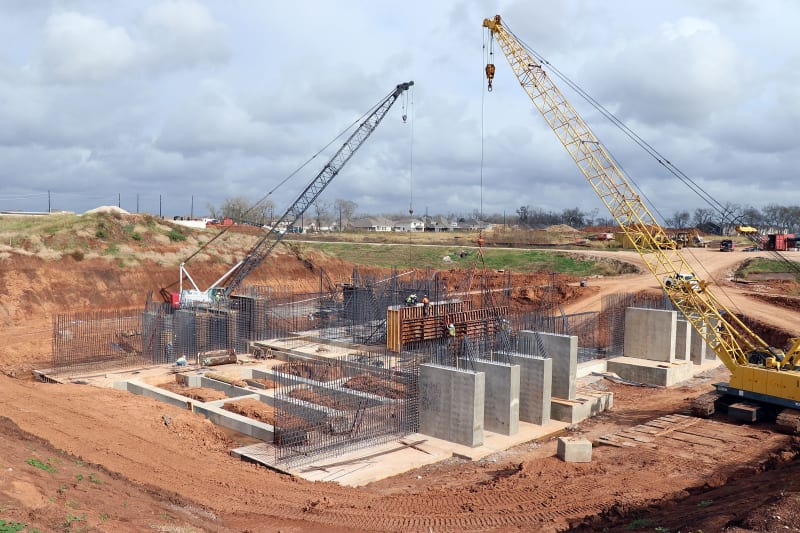

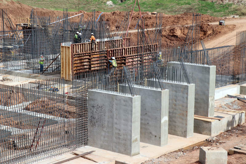

Here's 2 photos from last week......the large blocks are the counterfort bases (4 per side). This is an outfall structure that penetrates through a levee. For constructability, I use the same counterfort base at the bottom, then I start to make geometric changes in the upper regions. The shorter counterforts don't need as much steel.
I also transition to normal battered cantilevered walls when the wall height gets down around ~22ft or so.
The huge grade beams you see tie the two sides together to keep the walls from sliding (the grade beams didn't seem that large on the plans - I might have overkilled them a tad bit.)
