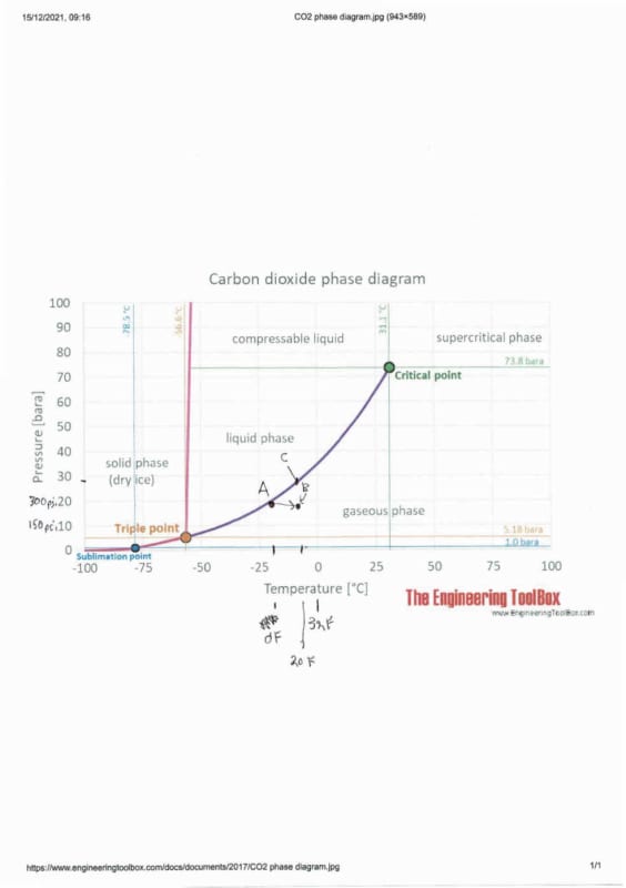

To understand CO2 you need to use the phase diagram I posted above and annotated below.
It sounds to me that in your storage tank (285 psi @ 0F) you may just be at point A where there is liquid CO2 in the tank. But it might be a tank of gas as this is right on the line. Even if it's a liquid if you maintain the same pressure ( how do you get it to flow?) and the temperature increases as you go along your line, then the liquid CO2 will boil as it moves right on the graph but at the same or similar pressure. Therefore you will get gas at your mould at point B.
Then somehow it returns to the tank as a gas. There needs then to be some mechanism to cool it back down to 0F to liquify it.
Long and short of it is that if you want to get liquid CO2 at 285 psi to the mould the temperature needs to be 0F or lower. Or if the temperature is 20F then you need to arrive at point C - about 400 psi.
Does this make sense?
