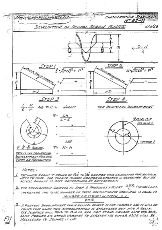

1) Why is the machine Tilted? What should be the tilt angle?
2) Why is the back support very strong? Basically from what I understood, there should be 0 movement in the support
3) Why the Standard flight flat plate calculations does not match the results? I have even used catia and soldworks to flatten the spiral, however there is always a gap after getting desired pitch. i.e. the OD and ID should be less than calculations
4) What should be done for spring back? If I increase the pitch, I dont know how much to increase since that will again change the Inner Dia.
I am trying to making this machine however I am not able to understand its theory. I have done many budget trials however the results are confusing me further. If anyone can shed light at this topic in Detail, that would be really helpful.

1) Why is the machine Tilted? What should be the tilt angle? To make it easier for the machine operator to manipulate the parts.
2) Why is the back support very strong? Basically from what I understood, there should be 0 movement in the support. Because the machine is capable of producing a lot of force, even if its full capaicty is not needed for the product shown in the YouTube.
3) Why the Standard flight flat plate calculations does not match the results? I have even used catia and soldworks to flatten the spiral, however there is always a gap after getting desired pitch. i.e. the OD and ID should be less than calculations Poisson
4) What should be done for spring back? If I increase the pitch, I dont know how much to increase since that will again change the Inner Dia. Develop a set of empirical data.
For flat pattern:
Incremental bending on radial lines to generate the flight.

I have already done this calculations however the results are same as Catia. which is standard calculations. The Note says that radius has to be greater than calculated however if I decrease the calculated radius, I get more accurate results. For 3rd Point, Noted however what is the solution for that? I believe there is more to this calculations because of the plasticity of the material. I got some values from Russian company who were making this machinery and their values were a little bit less depending on the pitch which were matching exactly on pipe/shaft. I am trying to understand that concept.

Having been around these machines some 50 years ago, I may be able to offer a few pointers. The machine is usually inclined at 45-to-50-degree angle to enable 2 things, one to center the blank on guide pins, two to aid the operator in loading and unloading. Remember that because of the difference in pitch angle between the inner and outer faces of the flight the metal has to stretch as the helix is formed. Parametric modeling programs do not deal well with patterns that stretch or shrink hence the problems generating a flat pattern.
Since most of the forming load is at the center of the flight, the design of your machine does not look adequate at the top/ center.

Regarding the pitch angle difference, I read a patent on this machine here:
Patent PDF
It clearly says that we have to take the mean radius of the flight for center of bending hence equally formed on inner and outer pitch. Am I interpreting it wrong?
I understand regarding the stretch and parametric modelling, however there are companies who make these machineries, and they have perfected their software to get accurate ID and OD for blanks. I have also used those in demos.
