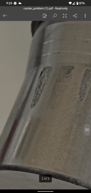

i have really strange case about cardan shaft problems.
I attachment you find some photos about one of the cardan shaft failured.
This is paper mill company and have big trouble during last year. All motors are DC motors with one AC/DC drive per unit motor.

I don’t work with cardan shafts at all. But my understanding is the arms of that cross form the inner race of needle bearings that oscillate position (don't continue rotating through their full range like normal bearings). One of the photos (below) presents a distinct pattern where the damage is heavier on one end of the inner race than the other. For a simple needle bearing, that type of observation would suggest to me a cause of excessive misalignment… but I’m not sure if the same conclusion holds for cardan shaft bearings.
In terms of what changed the two captain-obvious uninformed swags would seem to be alignment (maybe a different guy at the same company) or parts (maybe inner ring material is more susceptible to fatigue).
Again I have zero cardan shaft experience to go with that. I’m sure someone else can provide more insight.

Are you saying there have recently been multiple cases of u-joints with this same damage?
What is the brand name on the Cardan joints? Both old reliables, and recent troublemakers.
It looks like those 3 or 4 needles were edge loaded pretty badly.
I suspect (but do not know for sure) that needles in good quality cardan joints are very slightly crowned ( a few µm / .0001s inch) to make them WAY more tolerant of small misalignments between joint cross journals and cups.
I picture a few things might cause such damage.
1 - Missing needles. There should be a full complement, with no room for more. ( assembly error, manufacturing error )
2 - Poor ID OD concentricity of the Bearing cups. (Poor quality manufacturing)
3 - Bent or poorly machined Cardan cross
4 - Bent or improperly machined yoke ears. Damaged yoke ear bores. (beyond the control of the Cardan joint manufacturer)
5 - IMMENSE torque overload (But I'd still expect more even full length needle loading, and one side of each of the 4 journals on each Cardan to show indications.)
Investigating all those 100% would keep me busy for a while.
A dial indicator for 2
V-blocks and a dial indicator for 3.
A precision pin several inches long for 4.

Other than mechanical evident failures, what left me puzzled is the fact that it is happening in all the cardans at the same time while all the other surrounding conditions have not changed ..... I think, but I can be wrong, that the obvious cause of the damage is only the effect of a more structured problem
i'm going to verify alignment of some of the cardan shafts, i'm going to verify if nothing is changed on the motor control finding some tips can reveal the righ way to follow
That looks a lot like spalling to me. I have seen it caused by fatigue and I have seen it caused by hard impacts.
I would expect to see fretting corrosion type wear if it were a lack of oscillation. Do you see corrosion products in the lubricant?

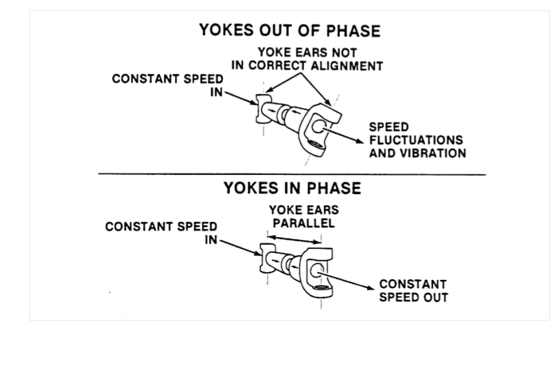

Is your phasing correct?
