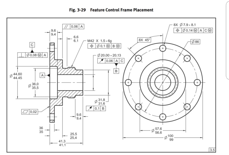

In fig. 6-30, what tolerance controls the length of the threaded M42 section?
There are basic dimensions 22 and 32, however while basic dimension 32 is clearly related to the general profile tolerance since there is a step there that is part of a true profile, I'm not sure what to make of basic dimension 22. It is given to where the basic diameter 36 ends and the thread starts, but is the true profile and the general profile tolerance zone well defined at that place? Part of the problem as I see it is that there is no step there to take part in a clear true profile (basic dia. 36 is only slightly smaller than the minor dia. of M42).

greenimi, this is the figure.
Figures in the standard are incomplete by intent. That portion of the figure and the applicable chamfers are not well defined.
I would read that 10 basic dimension (32-22) is the length of the full formed thread. But it is just me.
To complete a little bit more this figure maybe a note such as "CAD is nominal" or "refer to the CAD model for incomplete definition, basic CAD per model#######" or an equivalent note.

greenimi, good point about figures in the standard being generally incomplete, but this specific one - I think that other than the bit about the true profile behavior at the start of the thread (and chamfers as you mentioned), looks to me quite fully defined, isn't it?
Out of curiosity - suppose that the CAD model is not intended to be part of the definition, how would you suggest completing the missing piece?
To your question, I don't think dia. 31.6-31.8 is controlled by the general profile tolerance, as the general tolerance applies only to surfaces the variation of which are not "otherwise specified", whereas the size, form and location of the feature are fully defined by the size and runout tolerances.

chez311, I agree that if basic angles are added at both ends of the threaded portion this drawing becomes fully defined, and the length of the threaded portion becomes controlled by the general profile requirement, but I am not sure how inspection-friendly this is. I get why you suggest a directly toleranced distance to one of the ends of the threaded portion. drawoh's suggestion seems to be on the same line.
Interestingly,  the version of this figure from the 2009 edition of the standard had all the distances in the axial direction directly toleranced (see the image below). Most of those distances were non-size dimensions. I guess the committee's objective in changing the scheme to basic dimensions and a general profile was to further demonstrate that location dimensions shouldn't be directly toleranced. But would you guys disagree if someone raised a concern that the newer version  of the part design is costlier to inspect (relative to the older one below)?

But (speaking of verifying profile with a caliper...), could the 36 basic diameter in conjunction with the general 0.5 profile tolerance be more stringent than a direct tolerance diameter of 35.75-36.25, because the former requires perfect form at LMC, while the latter does not?
pmarc, I now see how the addition of basic angles at both sides alone does not fully define the geometry. This is how I think that a full definition in the first figure (from the 2018 edition) could be achieved:  The true profile on the left side could be defined by the basic 36 diameter, the basic distance 22 (which is given to the internal theoretical corner), and a basic angle which would be added. On the right side, the true profile is defined by the basic 32 distance locating the step, and the additional thing required would be the chamfer size between the thread and the step. The drawing notes could tell what the unless otherwise specified internal corner radii and external chamfers should be, with a direct tolerance. Does that seem OK?
Burunduk,
To answer your first question, it depends on what you mean by more stringent. It is true that the way the 36 diameter has been toleranced in the 2018 figure requires perfect form at LMC, but on the other hand notice that the general profile of 0.5 creates tolerance zone boundaries that are 35.5 and 36.5 in diameter, which means that the size tolerance is doubled compared to the 2009 figure.
Also, I think the change they introduced in 2018 regarding the tolerancing method for the 36 diameter is of different nature than the changes for the axial dimensions. As you pointed out in your initial post, the axial dimensions were changed to support the argument that non-size dimensions should not be directly toleranced. But in case of the diameter, they simply fixed the error made in the 2009 where a geometric tolerance of location was simply missing. And they chose general profile to fix this. So I wouldn't really try to compare the two figures in that aspect.
Regarding the second question, I would probably just add another basic diameter on the right side where the chamfer starts.
pmarc, that's a great input.
I suspect that there might be another reason for the basic diameter 36 in the '18 version other than solving the location issue from '09 though. If diameter 36 didn't become basic, they would have another problem with basic dimension 22 and the true profile being well defined. Would you agree?
Yes, I would agree with that.
