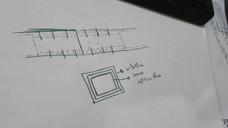

Hi all
I have two beams with box section members , we want make splice for it and the suggested splice from architect to insert box in between
With length 400 mm from each side and we will add only some bolts for fixation between the main outside beam boxes and the inserted box .
The gap between the inserted box and the outer beam 8s 1 mm from each side.
My question is the inserted box should be designed based on the same moment on the external beams

Do you have a sketch of what you are trying to do?
Actually we need to add only bolts from top only and depth of embedded box can be 800 mm 400 from each side
We need to depend on bearing for transferring forces not bolts
Is it a tension member? if not, why so many fasteners?
Actually this is a continuous beam which has moment in both direction and shear both direction and axial compression

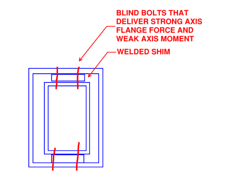

That sounds like a tall order for a rectangular tube. Assuming that gravity moments dominate and that you'd use blind bolts, I might abandon any attempt at a snug fit in the lateral direction and attempt a connection like this, wherein the bolts are structural for both strong and weak axis moment transfer if possible.
