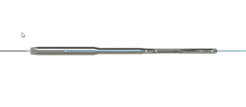

I'm mostly a software engineer by trade, but I have a cycling hobby and been learning CAD and composites on my free time lately.
Her is the result of my latest efforts:
Gyroid infill:
Actual 3d printed parts:

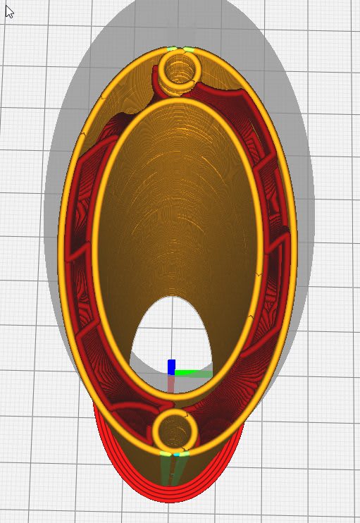

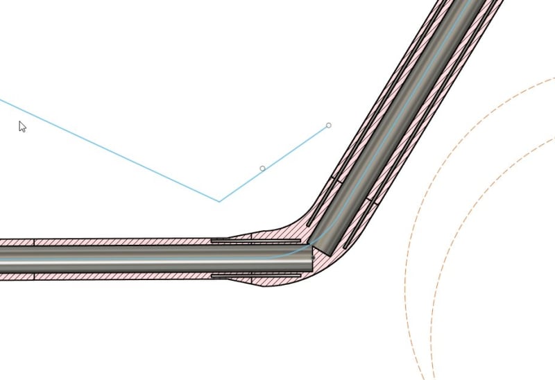

Basically, my idea is that by 3d printing (carbon-filled petg, pretty tough plastic with good adhesion to epoxy) you can play with part shape, internal 30mm (1.5mm thickness, mostly 0 deg layers, a few 90 deg) carbon tube will provide bending stiffness, it will be wrapped with a thick carbon sleeve (about 1.5mm wall thickness) for torsional strength, making a kind of 'tube in a tube sandwing'. The bends with interrupted tube will be wrapped with more carbon.
The tail section is 60 by 40 oval with outer layer (1cm thick) printed in shore 95A TPU, inner layer an other petg (I've read that graded core stiffness is good idea for toughness) with 3mm carbon rods as both locating pins and to give some additional bending stiffness epoxied in.
The idea is that it should be not too heavy, relatively easy to make, and the tail section should work as some suspension.
The rear wheel, btw, is asymmetric cantilevered, there are precedents of that:
Any tips on layup or constructive criticism before I commit to cover it (and myself in the process, grumble-grumble) with carbon and epoxy?

I suggest blending those inner tubes somehow, you have have cracking at those weak points.

Oh, sorry, I should have included the picture of my current bike, this frame is an sort of 'sidegrade' - I don't like downsizing the wheel, but it should improve aerodynamics and make bracing for pedal strokes better in comparison. This is a moving bottom bracket (MBB) recumbent:
Angle is to eliminate fork flop and more or less centre weight distribution around steering axis for less 'steering into a lean' moment (some is good, too much is not) and give more bar leverage for pedal strokes without resorting to very wide bars - singletrack vehicle dynamics is something I've had to learn as well and this is actually a surprisingly complex field, blending both mechanics, physics and biomechanics and even psychology.
Blending the tubes would be nice, but too complex. I will just give more carbon wraps in this region... both 45 and 0 deg. The beauty of carbon (besides that I have no welding facilities whatsoever) is that if something is not stiff enough, you can add more layers relatively easily, but I'd prefer to make it as good as I can withiout exposing myself to epoxy multiple times, I don't like working with it much to be frank.

Braking and drive torque will both make for significant moments at the head tube joint, braking will be the larger one.
At first I was concerned about moment due to weight at the head tube, but it's actually small because it's right over your front contact patch.
BTW, do keep us up on progress, I'd like to see the finished project.
I used to do testing on carbon fiber road frames. They take a lot of load in all axis.
If the CF is not laid correctly, it can crack when sees load.
If you run that tube thru the frame, I suggest making it one piece.

Yea, due to 90deg steering angle and more or less conventional trail there is not much *moment* on the head tube except what braking/pushing hard (and due to now 20" wheel - not that much either).
I understand that interior tube should be 'whole' and interrupts create weak spots - it is quite apparent by flexing the frame mandrel with interior reinforcements already in place.
I'll have to add considerable extra exterior reinforcement in those areas.
Those 'half shell lugs' will be glued, bolted and than additionally wrapped around. I've had them vaccumed over a 3d printed mandrel.
Because I'm not clear on it, how do loads get transfered from the applications points to the CF tubes inside the shell?

First, your going to be heavier and weaker than you expect with 3D printed parts joined with composites. Ive done a lot of testing with various 3D printed materials in hand layup, prepreg and presurized (autoclave) cure. 3D printing is fairly strong in the X and Y but VERY weak in the Z. Even for molds, the 3D printed parts require post machining and then even uner heat they distort in the Z uncontrolably. The material is weaker after each heating but I havent tested enough to know when it settles in strength.
The printed layers will break quickly with bending. Its just the nature of layering up thermoplastics and their lack of strength in bonding.(for what you are doing) The CF reinforced melted plastic does not create a isotropic reinforced layer when its printed one on top of the other. I cant quite tell by the pictures but is the rounded bends all 3D printed with straight reinforcements inside? If so the joints will fail pretty quick IMO. I think the carbon will be all of your reinforcement and the 3D printed part will act as a mandrel.

Yea, I should have printed the tubes at 45 deg or whereabouts perhaps, but than it introduces overhangs, unless you print it very thin layer, and than it will take forever...
Anyway, I do not expect a lot of strength from 3d printed parts - but than in places where tubes are interrupted it will be triple-wrapped, and in places where there are carbon tubes inside it is basically a *sandwich core* and it does not need a lot of strength and stiffness to do a very useful function - that's the beauty of sandwiches, basically... at least that's the general idea.
The 'tail' section WILL be flexy and is designed to be flexy *vertically* - but should be stiff in torsion and laterally.
