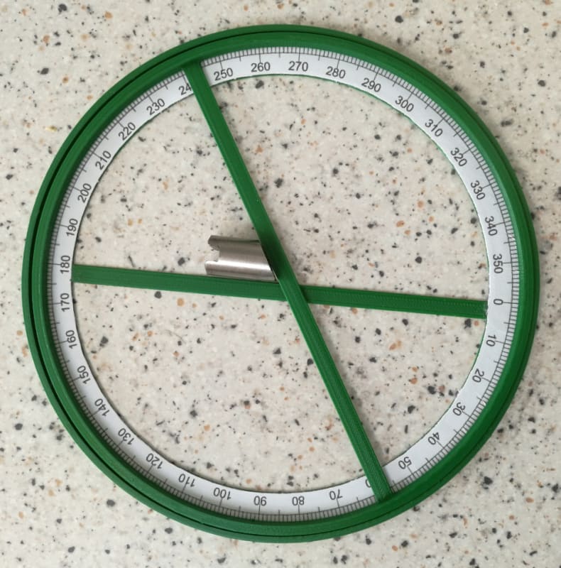

Given the rise of 3d printers one could just print a couple of "inspection" gauges (depending on the accuracy required, measure the gauge first and call them a comparitor). It might also actually work for repairs as well.
badservo… 18 Nov 21 19:57... elegant/sweet!

OMG I have to get/make one of those. :) Guessing I could slip a 2" wide part right through and have the angle in seconds. I'd prefer a more robust version, but now that I've seen what I'm looking for, I'm sure I can turn up a variation. And I have the CAD tools I need to alter this design to my needs PLUS friends with FDM printers, too...

Ideas coming to mind: The ideal tool would be one that has the center of the protractor at the vertex of the intersecting straightedges. The tool that I posted, and those posted by MintJulep, all have the protractor center offset from the straightedges. That's why the ruler has to be adjusted every time you move the angle. The tool posted by Badservo fixed that - but encloses the protractor in a ring, limiting the size of the part it can measure. Sure, print a bigger one... but I think I have an idea that will do the same, but not need an external ring...

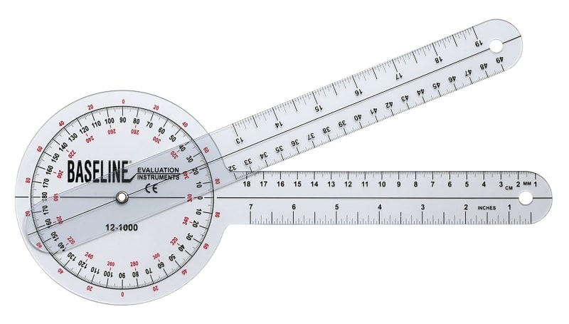

That leads me to find the "goniometer". For some reason the linear scales do not have graduations starting at the vertex. Nor can a part be aligned with respect to the goniometer's vertex, either. The vertex isn't really of interest on this tool, it seems.
This could also be used to find the angle, but it can't give you the flange length measurements.
