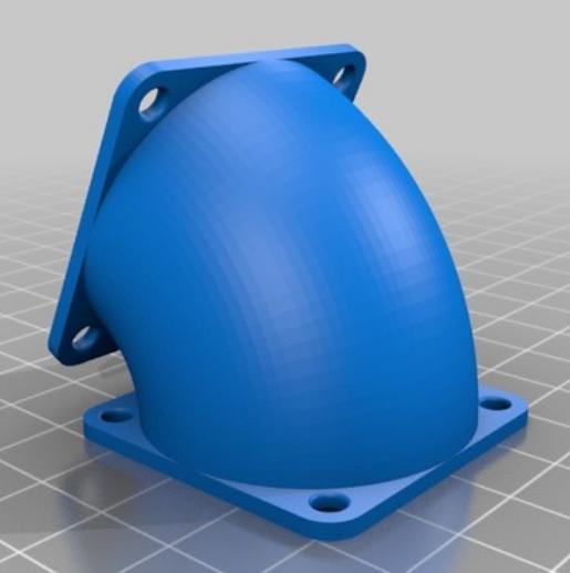

We used standard PC fans. When mounting them to a panel we found they moved a lot more air blowing into the narrow space behind the panel than sucking from that space. These days I'd 3D print a plenum off the panel to get a better more acceptable space for the fan to work in. Doing that you might find suction to be better AND you may be able to pressurize the rear plenum anywhere near the bottom optimized to miss stuff you mount on the panel.

When I was doing that work there were NO industrial PCs, that was what we were doing. Coming up with something that would house a PC in an outdoor enclosure. We eventually included a 1000nit large daylight visible LCD on it. We eventually cut a rectangle out of the back of the enclosure leaving about 1" of perimeter to the back of the enclosure. We then had a custom heatsink cast that was exactly the size of the enclosure 30" x 20". It was 1/2" thick with 1" vertical fins. We ran the ducted forced air behind the panel. We monitored the fan and the internal temperature for OTemp conditions. We found we needed quality fans with ball bearings. We ran the fans above a certain temp.

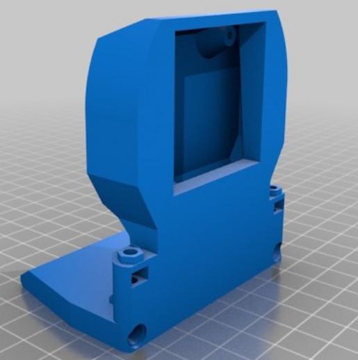

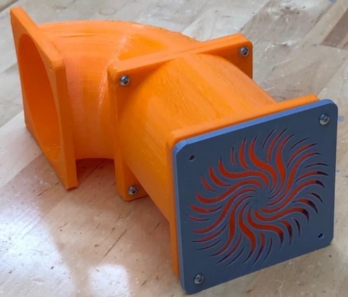

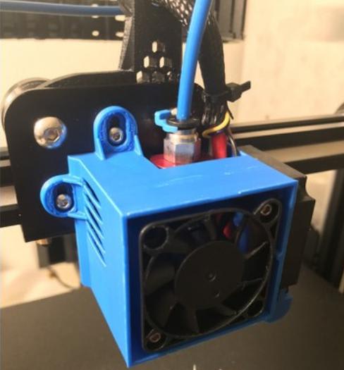

I think you need to get more creative in working a fan into your panel. I find it hard to imagine a panel that you can't find a couple of square inches to duct a fan up to. The fan could even be 90° to the panel just with an organic swoop to a mounting foot surrounding a port in the panel for easy screw down.
Example fan mount examples I'm referring to.
Something like the red one should get you onto the panel somewhere. You can also use the mini blowers instead of fans.
