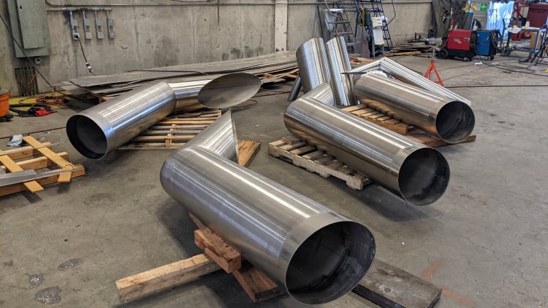

I know nothing about 904L. I'm building stacks for some of my boats out of 316L. I'm going to send them out for electro-polishing but that maxes out the budget. We see surface temps exceed 500°F (gold color) which sensitizes them so they require a lot of maintenance to keep shiny. I wonder how 904L would compare. How does cost compare?
500F won't sensitize them, but it will start to form surface oxidation which in high Cl environments will lower the corrosion resistance.
TBE, do any locations ever reach 600F? If not then you could go to 2205 as an option.
A lot more corrosion resistant and not much higher price.
