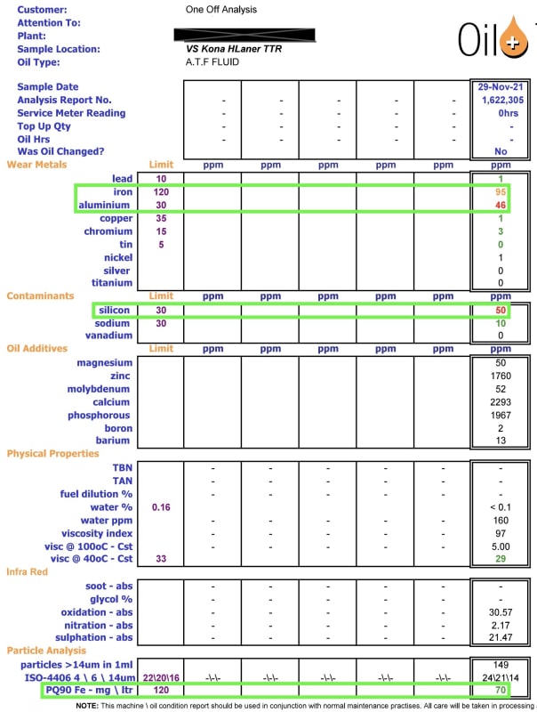

So, since I last posted a helpful owner in Australia has had an oil analysis done at a mere 3,700 km. I'm no expert at interpreting these but the ferrous results are what I expected, relatively low particles but relatively high iron. That's because, without a retention magnet particles continually circulate until they are ground down to dust. I'd wonder if that's the reason for the black colouration rather than oxidation? There are no external signs that the gearboxes are overheating and I checked the oil smell, nothing out of the ordinary for gear oil.
But the shocker to myself and the car's owner was the excessive silicon and aluminium. The car was not driven on dirt roads and is nearly brand new so we can't explain the silicon. Based on the gearbox design the aluminium could only result from bearing outer race spin. A potential location and reason for that is the over-constrained situation occurring at the input shaft when the motor is mounted in place - a deficiency I've mentioned a few times in prior posts.
I'd like to hear further thoughts on the oil analysis. In the meantime myself and that owner are trialing the addition of a magnetic drain plug.

Something to consider when sending oil out for analysis, it all gets filtered to 10 micron prior to testing. The smallest particle you can see is 30 micron. I have sent in oil samples with visible wear particles and they came back zero because they were removed before the test.
Some aluminum alloys have silicon in them. Bearing race rotation is always a possibility.

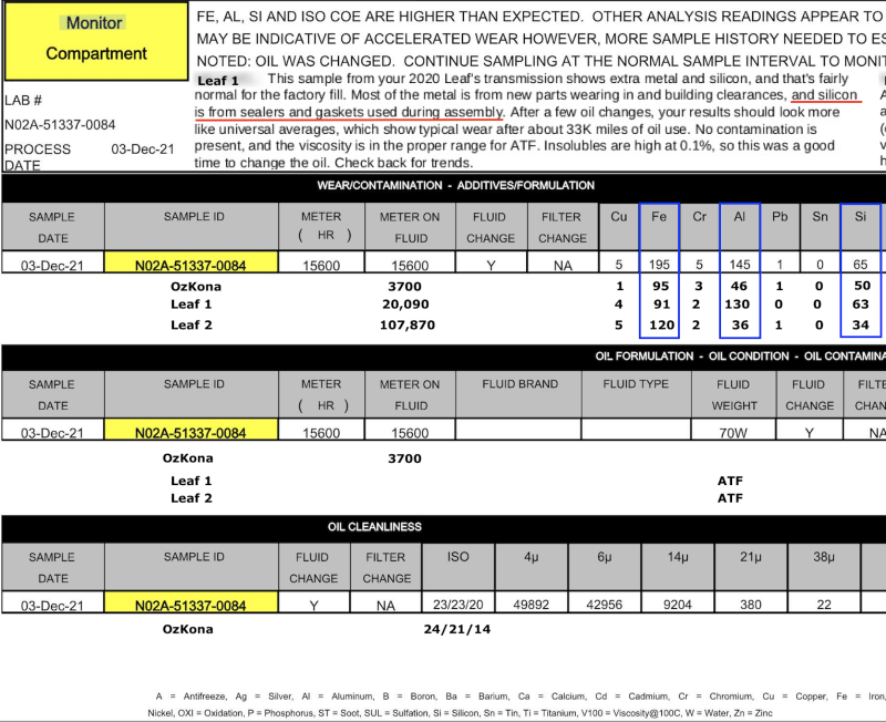

Thanks for the comments. I have two Kona EV and two Leaf EV analyses to compare. The analysis posted above is the second row of numbers, the Leafs follow.
The reason a Leaf is of interest is that the gear reducer design is nearly identical to that of the Kona. However, the Leaf uses Nissan ATF and has 2 magnetic plugs while the Kona calls out 70W/75W GL-4 and has no magnetic drain plug.
Several people have suggested that silicon could come from the silicone sealer used to seal the housing.
The Blackstone comments for the two Leafs are pasted at the top left and right under the comments for the first Kona.
I've split the image up into two so that it's more readable. Under "meter on fluid" is kms driven.

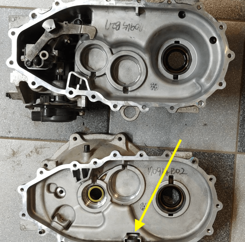

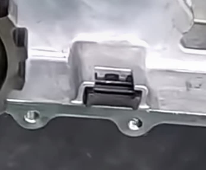

Just to update my post for the record, summarizing the issue and adding the recent findings:

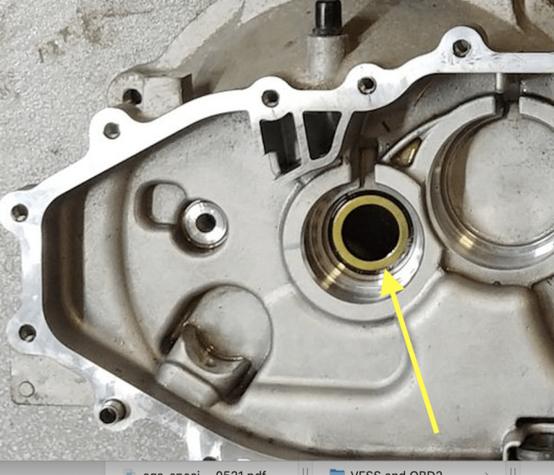

This EV (Hyundai Kona) has a simple 2-stage parallel-shaft gear reducer with a cast aluminium housing including an open differential on the output shaft, splash-lubricated with 1 litre of a 70W GL4. Input speed can be up to 10,000 RPM and the overall ratio is roughly 8:1.
A recent finding is there is a small non-serviceable ceramic magnet captured between the housing halves. Another recent discovery is that there is a circular bronze pad running (spring-loaded?) against the input shaft tail-end ball bearing inner raceway outer face. I can only assume that it's a brush intended to ground small voltages that might appear on the shaft generated by the motor. This would prevent discharge across through the bearing, intending to avoid an apparently common form of bearing damage when variable-speed drives are used. The Nissan Leaf has a pair of carbon (or sintered bronze) brushes running against the intermediate shaft. The Kona motor also has a circular carbon-fibre brush on the output shaft.
I had carried out oil changes at 19,400 and 19,500 kms, taking the opportunity to substitute the drain and fill plugs with magnetic types. The original oil was pitch-black at the first change.
About 20 other owners globally have also carried out an oil change with four obtaining a used oil analysis. Distance driven on their original oil varied between 4,000 to 100,000 kms but mostly at the lower end. All reported black oil, many with considerable sparklies noted.
UOA results (above) were relatively uniform and not wildly dissimilar to those from two Nissan Leafs. The Leaf gearbox is a similar design.
I've recently carried out an oil R&R at 21,300 kms and found the oil very clean. I just filtered it and reinstalled it.
That gives me confidence that there is not an ongoing issue, more likely that break-in wear particles are not being adequately sequestered by the built-in magnet. My tests indicate that the very fine particles don't seem to be readily attracted to a magnet and as TugboatEng pointed out, that content won't appear in the UOA iron PPM value either.
One owner reported that he had rebuilt the gearbox because the bearings where "gritty", adding that the magnet was clear of particles. I'm wondering if oil turbulence related to OEM magnet location may be a factor?
In any case the easy solution is for owners to carry out early oil changes to clear the break-in particles. I'm thinking along the lines of recommending 2,000 and 10,000 kms.

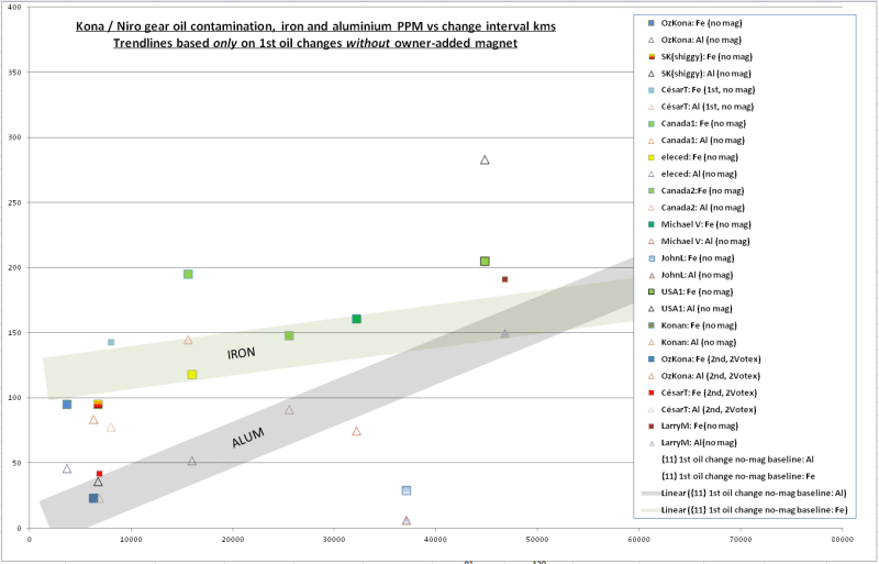

1. I now have (11) used-oil analyses for first-time oil changes from contributing owners covering drain intervals of about 4,000 to 46,000 km. I've graphed them as PPM vs km drain interval. As you can see, the numbers are all over the place. Most report notes describe the numbers as 'high' or 'very high'. There are also (2) reports from owners who have added a pair of strong magnetic plugs, as I have myself. They indicate lower iron levels as you'd expect.
2. I did a third oil change myself at 24,000 km after a drain interval of only 4,000 km. The old oil is completely opaque with a hint of glitter. The magnetic plugs had minimal particle loading. I will add that my Kona EV runs very quietly. The new oil is a 70W GL-4 and is a clear brown colour.

That seems logical but I'd have to remove the gearbox from the car and disassemble it completely to remove the captive magnet.
I think I've finally identified the root cause of the black oil and ferrous wear particle retention in the Kona/Niro electric cars.

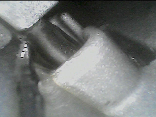

I used an inspection camera to confirm that the internal factory magnet is indeed captured loosely in its cast aluminium pocket.
Being directly in line with the oil splash off the final drive gear it's inevitable that it will spin and rattle, just like an object being squirted with a hose.
There was very little ferrous particle loading visible despite covering 24,000 km. I'd speculate that particles caught on the magnet are being ground against the aluminium surfaces as it spins, breaking those down and creating aluminium particles as well.
A short video here where I move the magnet around by moving a stack of magnets on the outside surface. While I had the camera in place I attached those magnets where they might hold the internal magnet away from the sharp feature at the left, what I'm calling a "nib". In 4,000 km I'll check the fresh oil and see if it's clear.
The moral of the story here is that a internal magnet needs to be held securely. Most likely one attached to the drain plug is the best solution.
