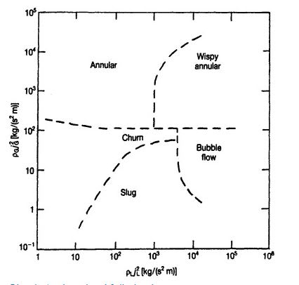

Dear all,
In our LPG plant, Process Gas at 95bars , 12°C @ inlet of Expander will have -41°C , 22bars @ the Oultlet of Expander and becoming Mixture Liq & Gas. However; this mixture goes through piping routed upward vertically to 15m from Expander centerline to the Vessel.
In other hand, engineering point of view, we always make slope downward to the Vessels.
Please can anyone explain to me, why the liquid in this configuration will not backflow towards the Expander.
Regards

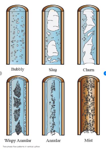

You need to characterize the two phase flow downstream of the expander, which is vertical upflow, to understand what is going on.

It's not an exact science, but it can give you insight into the flow patterns. I just snipped random examples below to show the basic idea.
You'll need to research and find a correlation and phase map for your situation.

Thanks Mr Latexman for your technical reply that I do actually appreciate them very well. for our case, Which of the Flow patterns can be our case in order achieve this flow without problem.

This was an interesting 2 phase flow observation which I believe is assisted by the formation of very fine drops from the expander, and easily carried along with the gas flow. The coalescing to a liquid phase requires low velocity and a little time. The actual settling time is from Stokes Law considering the droplet size and density.
Condensation of a liquid phase from gas (or second liquid phase from liquid) by dropping bulk fluid temperature is very fine droplets. Ground fog and clouds in the sky are common examples of mists with drop size way smaller than any liquid condensed on heat transfer surfaces.
