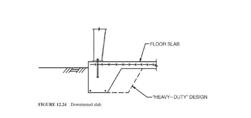

Is there any way to do a 50' span pre-engineered metal building foundation having the main frame columns supported on the edge (next to 1.5" sheet ledge) of the slab if the footing does not extend past the slab? Wouldn't be able to count much of the footing area that extends underneath the building slab for allowable bearing pressure because of eccentricity? Or am I going crazy?

I've done many small PEMBs supported on a stiffened slab edge; is that similar?
RE: Edge Column PEMB
The simplest reasonable foundation for this case, DOWN TURNED SLAB.
The figure ( copy and paste ) from Metal Building Systems ( by Alexander NEWMAN )

For clearspans 60' and less, or modular PEMBS that have interior columsn 60' or less, you can generally get a turned down slab to work as shown by HTURKAK. Turn-downs don't do well over 60' columns span. The work real good on 40' and less. Once you design for uplift, soil bearing is generally ok unless you have crane loads on the column.
The grade beam is like part of your foundation in the turn-down scenario. The foundation is more of a T-shape.

Ron247 is dead on with the foundation. Unless it's being used for crane operations or it has a 60psf+ snow load, uplift will control the size of the footings. It comes down to detailing the steel in the stiffer portions of the slab (turndowns, etc.) to resist it.
