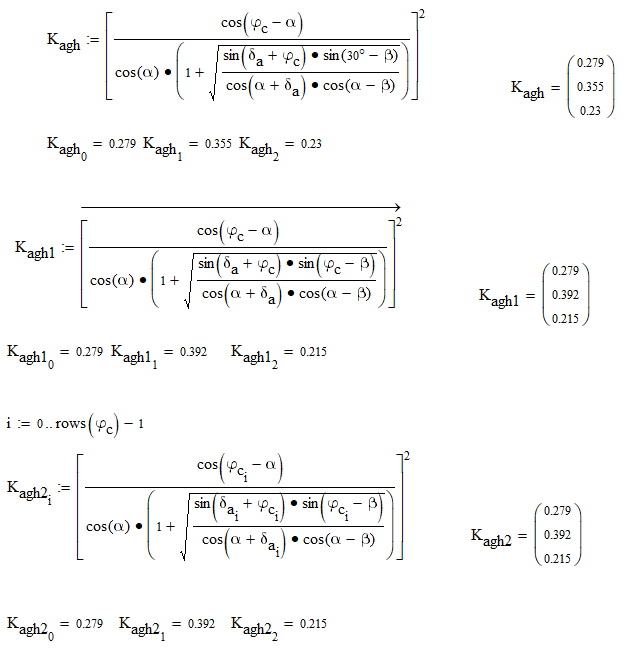

i have a Problem with MathCad 15. Iam new to the Software.
The Problem is only with the following Parameter ( phi.c[0..2).
The Formula with the hopfully correct declaration but the wrong solution:
With try an error i found the Problem Part it is the sin(phi.c) if i just type in the correct degree it works.
I have no clue what i did wrong.

It IS a common problem, but better to see it than to make a rash assumption.
You've defined phi as a vector and passed the entire vector into the definition of K.agh. While that's technically correct, Mathcad doesn't always behave correctly because you have other vectors in the same equation. I couldn't tell if the indices for phi and delta were correlated, or not, but this is what I got, and note that the second two results for K.agh are different than what you got by putting in 30° directly, since that winds up using only 30° for all three indices. You have two choices for fixing it
TTFN (ta ta for now)
Thank you so much!! Yes with 30° i only have the correct solution for K.agh[1
I will take the second option and in the final print i just hide the definition of i.
Nevertheless thank u so much !
