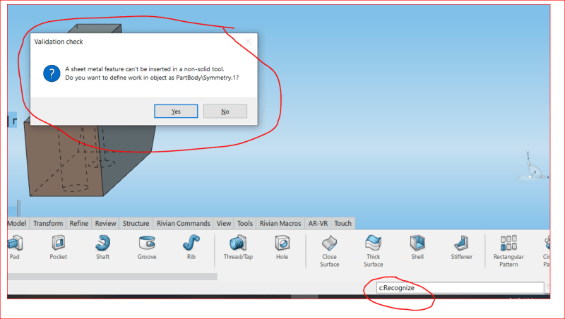

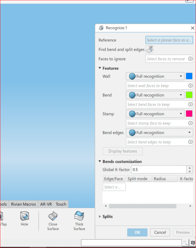

I am trying to get the Catia Future Recognition tool on my current 3DEXPERIENCE device.
I found on YouTube something identical, posted by our member, Ferdo.
But I can't find any of the feature that provide this enhancement (please, see the red marked area):
How could I get it?
Thanks............

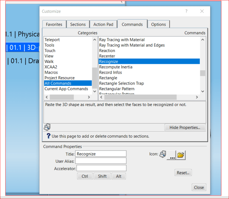

CAD 2015
I believe that for Design Feature Recognition(1) is required FR1 license.
I couldn't find it on Preferences (Shareable Products/Licensing).
Maybe its a company policy option.
CAD 2015
I got it, thank you!
CAD 2015
I did find something similar, but I believe that its in regard with sheet meatal tasks...
Any ideas?.....
Regards,
CAD 2015
That's right Ferdo (the message in the window shows that very clear).
But I was hopping that we can find some derivation from it and adapt to the current environment...…
