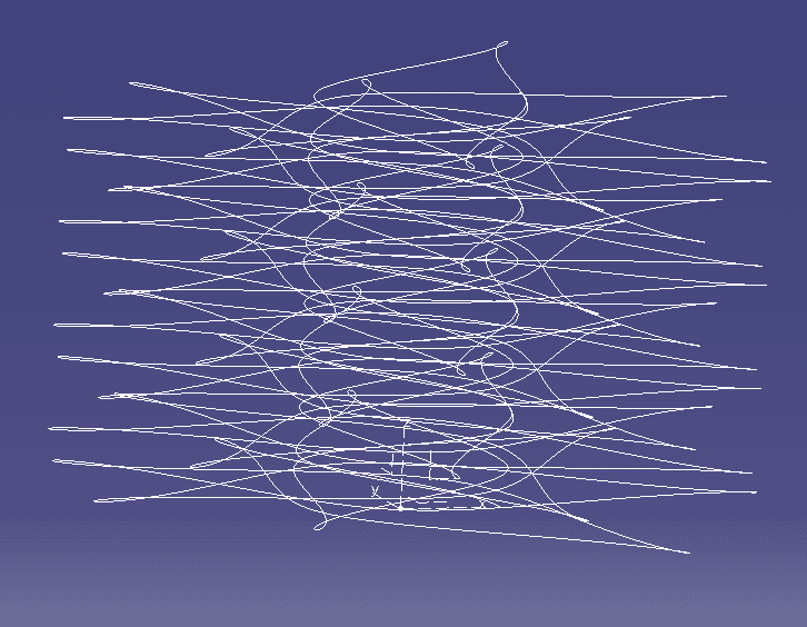

Hello everyone,
I am using Catia curve from equation to build a curve. Here is the formula for x and y:
x = R*cos(2*PI*1rad*n*t)
y = R*sin(2*PI*1rad*n*t)
So n is a parameter I defined. When n is small, the curve is a circle. However, when n is large, like n=100, it is not a circle anymore. Instead the curve is very weird.
How can I make sure that the curve is still a circle even when n is large? Because mathematically it should be a circle no matter how large n is. Any help is appreciated.
 https://files.engineering.com/getfile.aspx?folder=d1a0910d-8be2-4771-a3bb-98e27f10b28b&file=Weird_curve.PNG

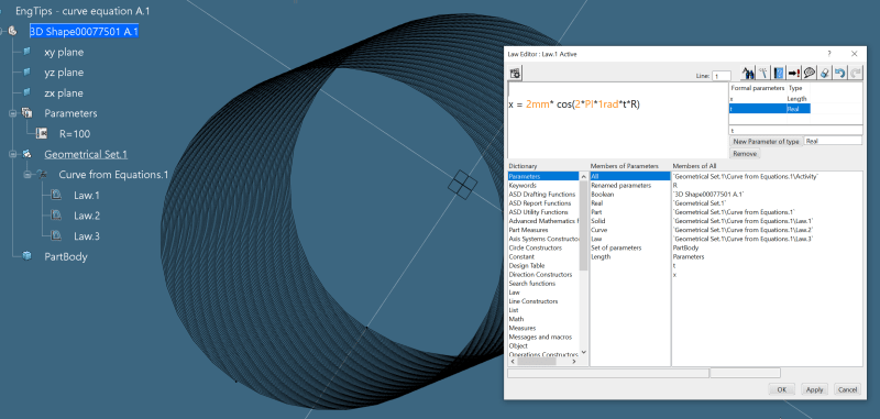

how exactly did you implement your equations?
with x and t as variables in a Law (real), and R and n as external parameters?...
regards,
LWolf
LWolf, you are right. That is how I implemented. I even tried the following cases:
x=20mm*cos(2*PI*1rad*40*t)
y=20mm*sin(2*PI*1rad*40*t)
z=0mm*t
I changed 40 to 100, the curve is not a circle anymore.
Yes, I saw that video before and I followed the instruction. The only thing I do not understand is why the curve is completely different when I want to have more revolutions.
I get the circle... (as I should), no matter how many revolutions (N number).
can you post a picture when you vary z=N*t ?...
regards,
LWolf
LWolf, below is my definition:
`x1`=25mm*cos(2*PI*1rad*100*`t`)
`y1`=25mm*sin(2*PI*1rad*100*`t`)
`z1`=0mm*`t`
The curve I got is shown below.
yeah, seen the first picture.
did you use fog to define the laws?
could you humor me and show me a case when you vary the z
regards,
LWolf
Below is the result with z=100mm*t
Do you think maybe there is some settings that I should make? The result is really weird.
Yes, I used fog to define x,y,z. Then used curve from equation

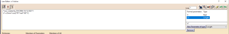

use real parameters, not lengths...
regards,
LWolf
LWolf, what do you mean by 'not lengths'? Please see my x1 definition below. In my definition, the type of x1 and t is length and real, respectively.
