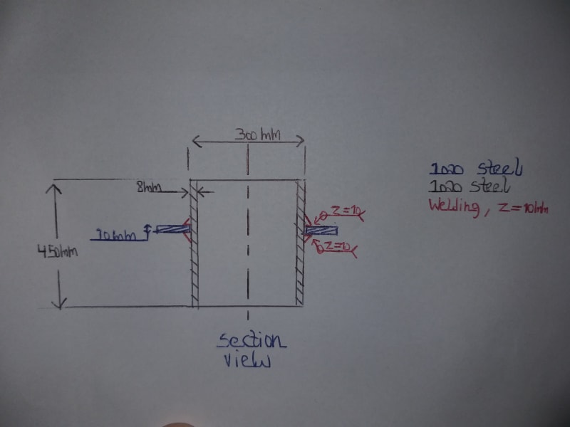

Are there any instructions how to choose welding technology (MIG, TIG, EBW, etc.) based on the relevant application?
I am designing a structure that should be dynamically (vibrations) tested soon, and I originally instructed to use TIG method.
The workshop prefers to use MIG welding.
I wonder what should I do? I originally chose TIG since I read it's the best quality welding.
But now after being asked for changing it to MIG I really want to deeply understand what the consequences might be.
When learning welding in the university we dealt with the size of the welding by dedicated calculations, but I couldn't find any considerations regarding which technology is best suited for the entire different applications.
It's largely determined by the materials being welded, the service environment, including load application and costs. AWS Hand Books and the ASM Welding volume. GTAW (TIG) is one of the more expensive proceses, especially manual GTAW. Having no idea what you are welding and its service, I cannot say whether the GTAW should be employed.
This part is carried by an aircraft, and its interface is the peripheral (blue) flange/ring.
The applied loads are accelerations and vibrations.
I attached a schematic picture of the part, its bodies and materials.
If you are truly concerned with fatigue failure you should make the welds full penetration with reinforcing fillets. Fillet welds in fatigue can have less than 25% of the fatigue life of a full penetration weld. As long as they are not using the short circuiting method of transfer and uses at least a 75% Ar-25% CO2 gas mixture, I would have no problem using GMAW.

Weldstan, what do you mean by reinforcing fillets?
Just to make sure - when (simple) calculations are done the penetration depth isn't taken into account, right? I will be grateful to know why in this case a full penetration is a key factor to safe design.
Thanks!
Reinforcing fillet welds (small fillets) are added on either side of the full peetration weld to better distribute loads.

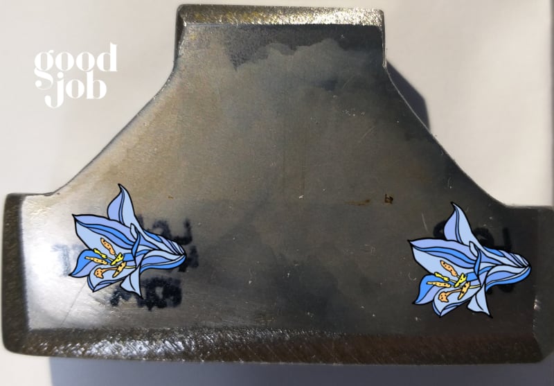

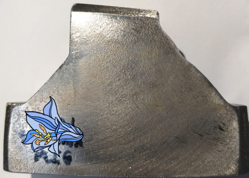

Today we had first trials of welding.
We first tries to find the best parameters for the welding process, so we welded 2 simple samples (simplified geometry with same materials and thicknesses) and cut them so we will be able to examine the depth of penetration.
We actually tried 4 set of parameters and here are the results.
