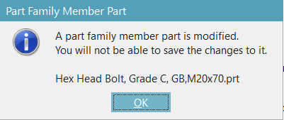

I appreciate your reply, however after editing the expression I receive a part family member error.
I suppose this is because I am using the default reuse library so it doesn't allow writing over the files?
