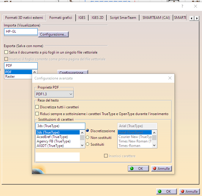

I have seen that when I export a 2D drawing in PDF format is not possbile to select the text in the exported pdf file. This happen both by saving the pdf file directly with Catia or with pdfcreator virtual printer. Anyone know how to have the text selectable?

Change PDF export settings in Options - General - Compatibility.
Which one should be? Discretize?
The other option is 1.6 but i don't think it is a matter of file extension option, I would guess that this is about how the PDF creator printer "see" the text when it generate the pdf file.
