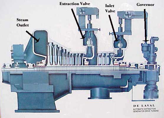

Please note that an actual expansion line from main steam inlet to exhaust, when plotted on an H-S diagram, is not a single straight line. For what you call the HP section, the expansion starts as a horizontal line (constant enthalpy) due to the throttling through the inlet flow path (main stop valve and governing valves), as well as flow passages between these valves and downstream of them to the inlet of the nozzles of the Curtis stage. The next portion of the expansion is a straight line which represents the Curtis stage efficiency. The following straight line, at a steeper slope, represents the efficiency of the stages downstream of the Curtis stage to the automatic (controlled) extraction point.
For your IP section, the expansion is similar to the HP section with a straight line representing the flow path through the extraction control valves, as well as flow passages upstream of these valves and downstream of them to the inlet of the nozzles of the secondary (Rateau) control stage. The next portion of the expansion is a straight line which represents the secondary control stage efficiency. The following straight line, at a steeper slope, represents the stages downstream of the secondary control stage to the uncontrolled extraction point.
Note: Please see the enclosed cross-section of a typical single automatic-extraction, condensing turbine below. Notice the secondary steam (extraction) valves and secondary control stage downstream of these valves. Also note that the height of blades in the first few stages in the IP section is similar to the height in the first few stages in the HP section due to smaller mass flow in the IP section.
For your LP section, a straight line represents the expansion through this section with a flattening curve at the end which represents the exhaust loss.
The GE method simplifies the expansion line by substituting an equivalent (straight line) efficiency to the final exhaust point. This simplification allows you to use a spreadsheet, rather than a sophisticated modeling program, to estimate turbine performance.
