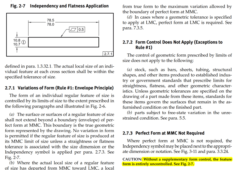

Q1. 3.3.24 Independency Symbol. "This symbol indicates that perfect form of a feature of size at MMC or LMC is not required." By default, perfect form at LMC does not apply already. When would this symbol be used to indicate perfect form at LMC is not required?

Regarding Q1: If independency is indicated, wouldn't a from control be required? And once the form control is indicated, doesn't that make the independency symbol redundant? I suppose the form control could be indirectly applied, like in Fig 2-7 where a flatness tolerance is used to control only the upper side of a feature of size. That use case makes sense to me.
(I) is to indicate that the drawing creator intended to have a form tolerance that exceeds the limits of the size constraint and did not make an error. Yes, the standard indicates that without a form tolerance on an (I) feature of size, that the form is uncontrolled.

Please note the highlighted caution for 2009 version

There is one more subtle, but quite significant, difference between the two caution notes. It is lack of "entirely" in the 2018 version. I assume it's because they realized that with the swept sphere interpretation of limits of size, as defined in Y14.5.1, (I) is simply not able to entirely cancel out form control of cylindrical features of size. I am pretty sure that this is also the reason why figs. 2-7 (in 2009) and 5-10 (in 2018) does not show a cylinder but a slab.
