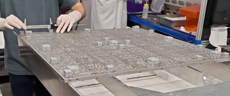

A little bit of background may help.
I am trying to measure the distance between parts 3D printed on a platform. The nominal value is 135mm and I am using Mitutoyo calipers. I want to know if the spacing is consistent across the build area on both X and Y axes.

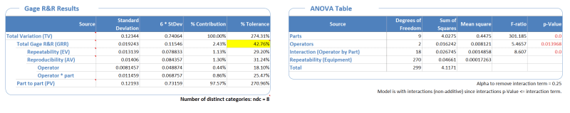

These are the results of my GRR. Notice the repeatability and Reproducibility are pretty even.
So if I understand it correctly, that 42.76% is true for a single measurement. But as I increase the number of measurements, the average of those measurements should approach the true (unknown) value.
Is that a correct assumption?
Thanks.

least squares is a poor way to get there, wherever "there" is. You have to quadruple the number to get a factor of 2 improvement. Quadrupling the test time is NOT a process improvement
Not sure how you configured your study, but the % contribution doesn't look that bad, so your % tolerance is essentially saying you might be trying to do something too difficult for your process, as opposed to having a bad process. The bigger question is whether your measurements are consistent with industry standards, as opposed to whatever your end goal is. If they are, then you need to find a better way to achieve your goal, as opposed to flogging your operators to do better measurements that might be not physically possible in your process.

A good place to start would be to not use the worst possible tool for what you are trying to do given what you are measuring.
First try with a go/not-go gauge.
