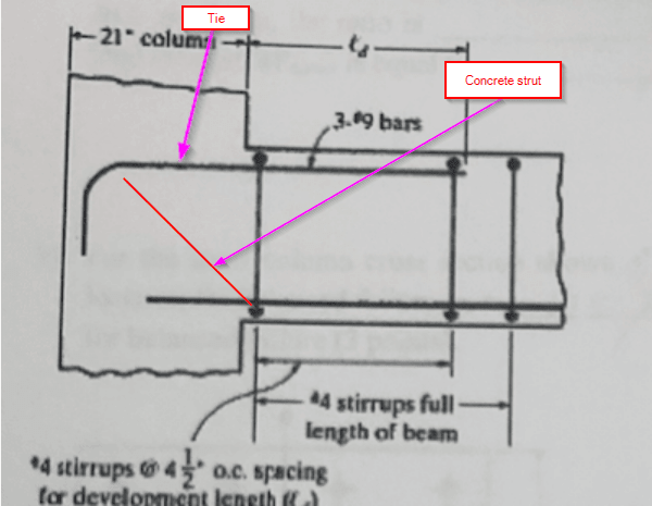

Would you say this could be considered as a moment connection?
2021-09-21_22_09_41-Rebar_Development_Length_vs_Anchors_-_Structural_engineering_general_discussion_ufu0qt.png
For the connection in the picture above, I know it is required to calculate the required development length of the tie, however, is it required to calculate the concrete compression strut as well?
