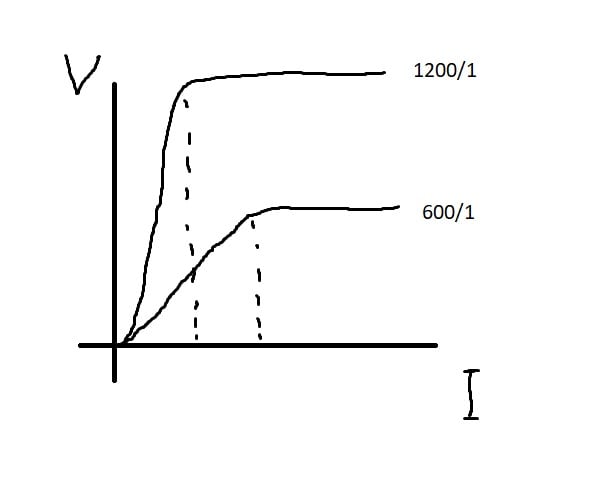

Ok, so do I understand correctly, in case of Class PX CTs (assume 1200/600/1) knee point voltage on the lower ratio can only be two times smaller than knee point voltage on the higher ratio. Same with resistance. But the magnetizing current will be the opposite. Is below image what you would normally see on dual ratio test graph?

Yeah - that graph looks about right.
