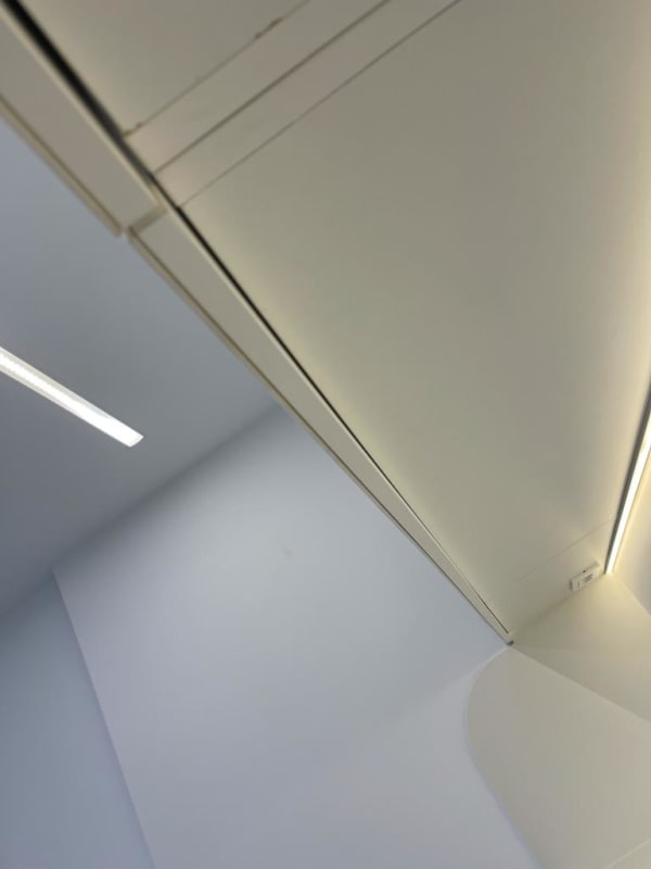

Hello guys, first time poster, hope to be a contributor too!
I am trying to glue some 3mm Laminam (XL size ceramic tiles) to Melamine coated chipboard 18mm, using a silicone gun and Neutral Silicone adhesive. I am having trouble with the panels bending afterwards, not at the time of gluing, but after a day, two, maybe a week, and it only keeps getting worse. Also had the same effect trying to glue mirrors to mdf or mfc. What do you think would be an appropriate bonding adhesive to connect such materials? Thank you all in advance!

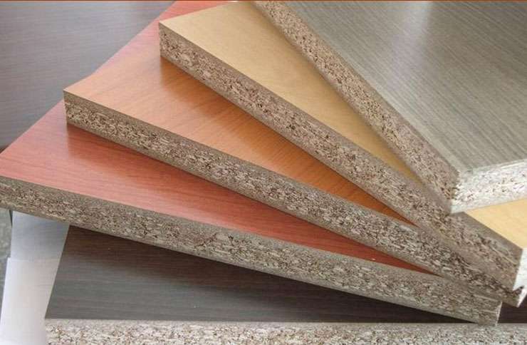

Thanks for the comment! The chipboard being glued is 18mm double sided melamine coated chipboard, it is what i can get in my country. Either that, or completely uncoated chipboard, but gluing to an uncoated chipboard yielded the same results (bending).
This is the material i am talking about:
This is a picture of the material after bonding, already half-bent

The MDF itself isn't dimensionally stable and is usually installed on framing to make it rigid.
Attaching a very stiff, water tolerant item (ceramic tile) to a not-stiff, water sensitive material (chipboard).
It takes only a tiny difference from humidity change to produce a noticeable warp. Notice that the melamine is on both sides - that's to balance the strain from humidity change.
You can make the silicone bond thickness much larger - 1/8th to 1/4 inch (2 to 6mm) to provide more distance for the strain to equalize, preferably not a solid bond but one with significant areas unbonded. Or make the bond equal with tile on both sides.
Wood expands and contracts a lot with changes in humidity. Ceramic tile does not. The wood panel also has a rather low bending stiffness.
RTV silicone also uses Hydrogen as part of its curing process so it maybe that it is drawing the moisture out of the wood causing that side to shrink and curl.
