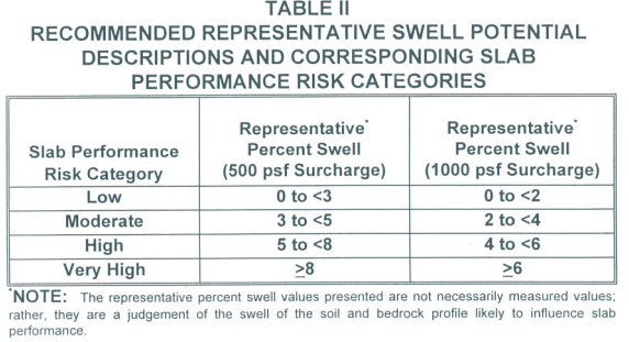

The older recommendations from the Colorado Associate of Geotechnical Engineers (CAGE) indicate that 1D swell results with a initial surcharge loads (before flooding the sample) of 500 and 1000 psf have the following slab performance risk category:

Yes, I know all about the 1D test and that is exactly what was completed for the site, ASTM 4546, and it came back at 2.16% but that is where I had to stop. That number really does not mean anything to me, is that a lot or a little? My educated guess would be that is on the low side, therefore an assumption of low-moderate swell potential for this soil will need to be designed for. Soil reports are not required for permitting in the rural areas (this is for a PEMB) and the owner would prefer not to spend the extra amount for a geotech to take a look, so I am attempting to learn a few things about this field. I know a fair amount but do not feel comfortable with relating the swell % from the ASTM 4546 to any real tangible data that can be used in a foundation design. And from the research I have done, it seems like what you have said, this area is developing and not an exact science. Some assumptions and estimating is definitely industry standard.

I can tell you if there was a site in the areas where I practice, an average 2% swell for the entire depth of wetting would be concern for sensitive structures, say for machinery that must stay level but less of a concern for less sensitive structures, say for an average homeowner. A lot of the potential swell can be taken out by excavating a portion of the expansive soil and replacing it with non-expansive soil. A PT slab or a structural slab founded on shallow foundations would be less risky.
