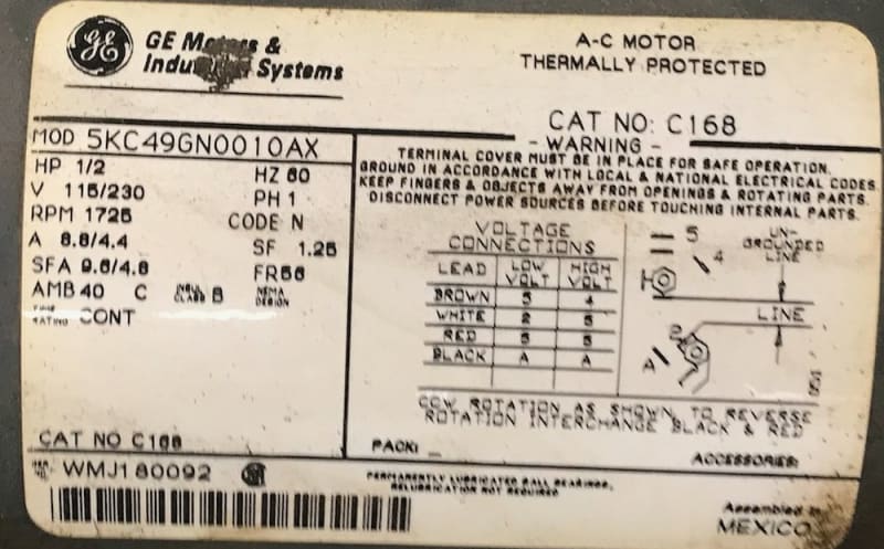

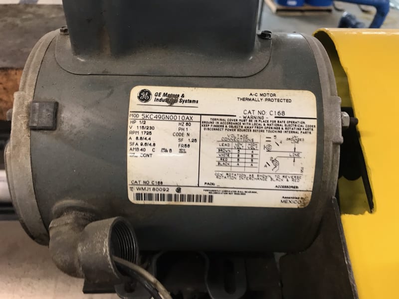

I'm building a control panel for a large machine. It's a 480V panel. At the last hour (rather than minute) I've been informed to not forget this motor (I've never seen or been told about).
My options as I see them are to:
1) change to the control transformer UP to something that will support this motor
or
2) change the motor over to a 480 3 phase equivalent.
What would you do?
If you're inclined to stick with this motor how big does the transformer need to be to support starting this cap-start motor?
BTW: The 480 at the site is WYE sourced.

Another possible option is a 480-240 V transformer (or autotransformer) in the panel. Motor full load is somewhere around 1.1 kVA. 2 kVA of transformer capacity would probably be enough. Maybe 1.5 kVA. The motor does have a 1.25 SF.
My first inclination would be to replace the motor with a 460 V 3-phase. You'd need a small (NEMA 0 or 00) starter including OL relay. That's probably $500. Maybe you can find a refurbished motor, but 1/2 hp 3-P motors are a little unusual. l

I would not feed it from the control transformer. The starting surge may cause unacceptable voltage sag.
I like the idea of a 480 Volt to 240 Volt transformer.
My transformer sizing:
4.4 Amps x 1.25 SF x 240 Volts x 1.25 by code = 1650 VA. I would use a 2 KVA transformer.
If you consider that the 4.4 Amps includes the SF, you are down to 1320 VA and a 1.5 KVA transformer.
The I2T of the starting surge is short enough that the transformer will withstand the short starting overload.

I like the 240V gambit and after a quick epay check for a 3P replacement I'll probably go with the 240.
Thanks Bill for the KVA work-up.

Who says 1/2 hp 3-phase motors are unusual? They're so inexpensive I would seriously considering switching to 3-phase 480v and skip the transformer altogether. $388 from McMaster means you could probably find one for half that price elsewhere.
Electric Motors, 208-230/460V AC, NEMA 56, 1/2 hp, 1725 rpm, Open Dripproof
They liked the new motor idea. They believe they may even have 3 new 240/480V motors bought to run fans that turned out to need more than 1/2hp. I'll keep ya all informed.
