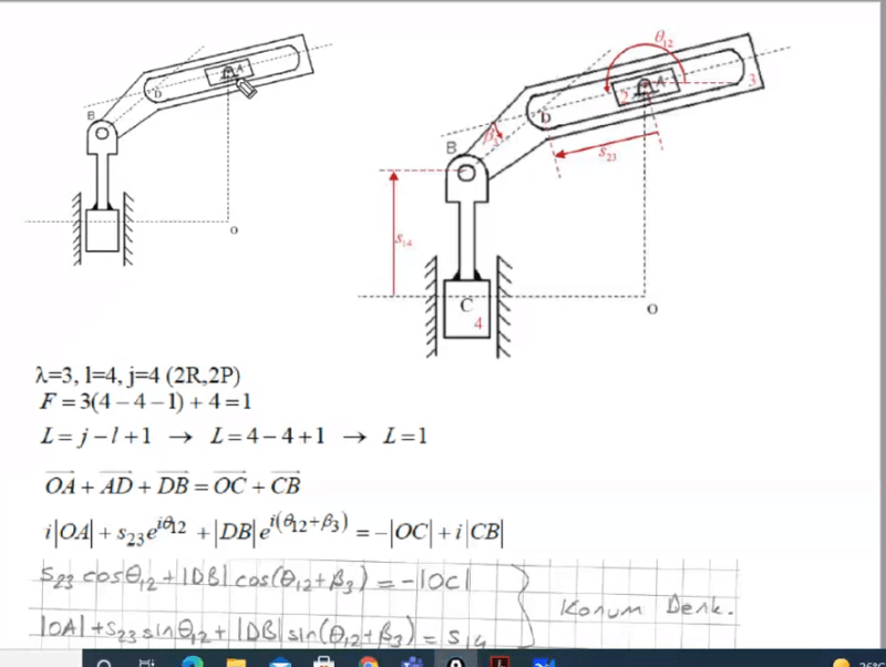

It's my first time taking this class and I don't know how exactly I can write dynamic force equations based on kinematic analysis.
Can you make dynamic force analysis with this kinematic equations.

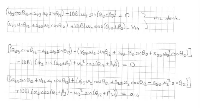

I have a homework where I need to pick a mechanism and write kinematic equations and dynamic force equations without any numeric values. mechanism cant be a crank biel mechanism or four- rod mechanism. But I dont know what do I need to do. I thought it would be possible to come up with dynamic force analysis based on the given information with this example.

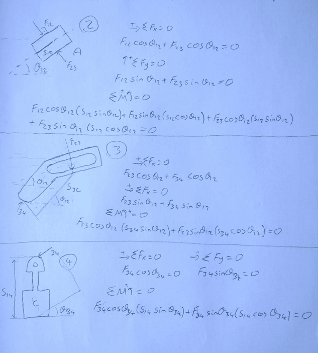

RE: Hello! My First Post. I need help on a problem
The masses of the items and their moments of inertia are missing. Massless, inertialess items have no forces.
Once those are known the forces due to linear and rotational acceleration can be determined.
Perhaps start with a less geometrically complex linkage such as in a single piston crank mechanism as driven by the crank? Then you have the mass of the piston, the mass and rotational inertia of the connecting rod and the centripetal acceleration of the crank. This offset slider adds too many trignometric terms for a first effort.
I tried to come up with these equations. Do you guys think that these equations can be written based on the shape given in the problem.
