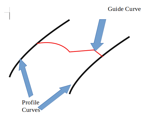

1. Lets say when I am doing a multi-section loft in GSD if I use guide curves, in the resulting surface I get a black internal line where the guide curve passes. Is there anyway to get rid of the this black line later? This black line presents an issue for many downstream operations and we would like a clean surface. I know Surface Simplification tool can get rid of them internal blacklines but for surfaces which are quite complex & curved, I have observed that resulting simplified surface quality is not good. When I run any kind of surface quality checks I can see lots of chequered boxes (especially in highly curved regions). Hoping that members can point out to any tool which can be used to achieve the above.

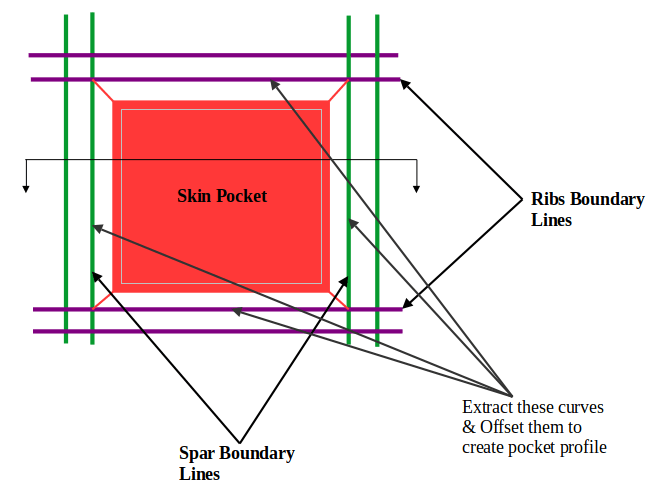

2. This question is regarding Part modeling procedure. I need to create skin pocket regions between spar & rib boundary lines. The issue is that skin is highly curved. I am including pictures which will hopefully give an idea of what I am trying to do. Purple lines are rib flange boundary lines & similarly green lines are spar flange/cap boundary lines.
My modeling thought process was that I will extract the spar & rib boundary lines from part and join them and make a curve offset of the join.
I will then offset the skin from OML and use pocket feature to remove material till the offset surface. Issue is that pocket or pad needs a sketch based profile and won't accept curve offset.
I need to create around 15 pocket regions through out the wing (30 if I include both top & bottom skins) and I am hoping for a procedure which is easier and hopefully parametric.

Answer to question 1: NO way to remove the "black line" it is a soft edge in the definition of the surface and limit internal faces. What is the impact downstream?
Answer to Question2: Pad and Pocket are based on profiles, usually defined by Sketches, but if you have several curves in 3D and those curve defined a 2D profile then you can Join then and use the Join for Pad / Pocket. If the profile is not planar you could make a surface/volume (in GSD) then use this with a closed surface in PartDesign and remove the feature using boolean operation.

1. Mainly concerned with aesthetics of surfaces (of course these internal soft edges can be hidden using View mode 3) but any internal edges are "transferred" to any downstream modeling (for ex: if the current surface with edges are used as parent for all children operations). Also, when we export the geometry for CAE operations using neutral formats, due to these internal edges, the surfaces are split in to patches which needs to be cleaned up again. Mainly are they requesting for a clean geometry.
2. I am not sure if I've tried a Joined curve as an input for pad or other sketch based features but I will try it out. Thanks for your suggestions. I really appreciate it.
