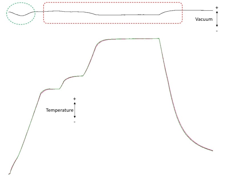

I've seen what sounds like similar things...multiple jobs/places. Example below is out of autoclave (oven cure, prepreg under bag)...
Initial vacuum drop (green oval in photo) during first temperature ramp which recovers, I believe to be moisture related... Moisture in the nylon bag, nylon breather, tool (material dependent), etc. being baked off. Running a bagging set-up (no part...bag an empty tool) recreates this.
Second series of drops (red box in image) are a bit harder for me to understand. Definitely functions of temperature...or, at least, correlate to temperature. Best guess is oven vacuum plumbing expanding at temperature and creating small "leaks". Big powerful vacuum pumps...but high differential, low flow... Recovers as everything cools down. <edit: we've also discussed bag permeability increase as a function of temperature as a potential contributor...>
Don't know if this helps or hurts...it's all marginally educated guess work.
