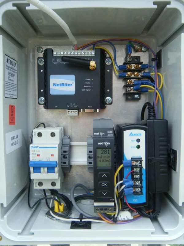

I don't know of any sensors directly. You may need to use something like NetBiter hooked to your sensor of choice.
Keith Cress
kcress -
