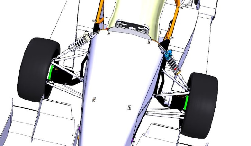

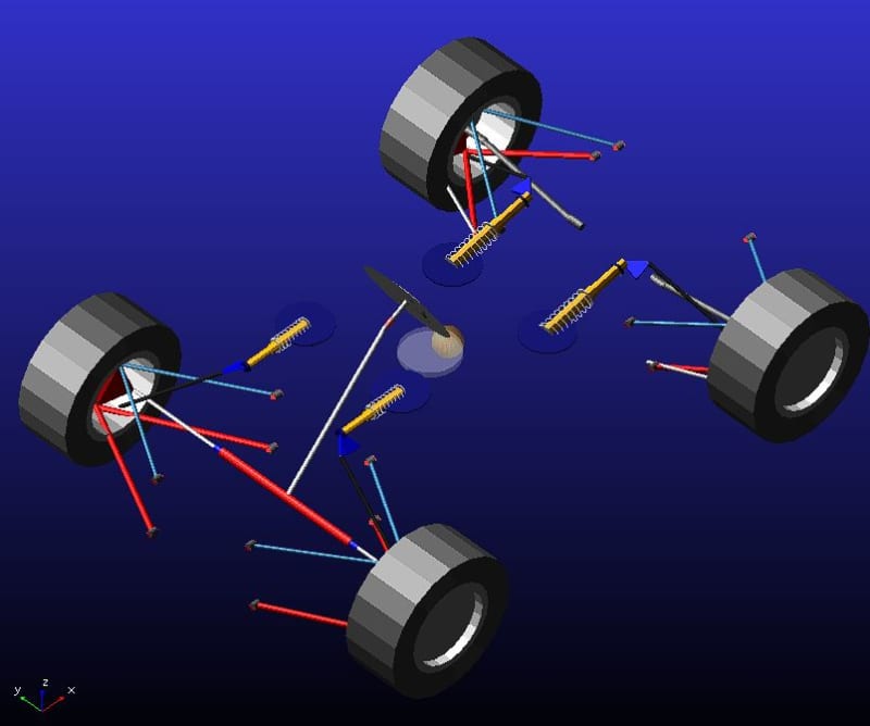

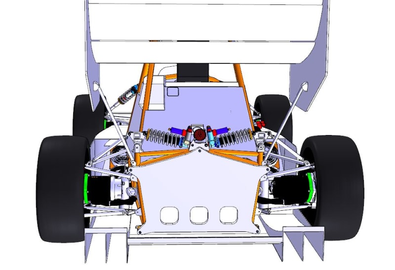

1} the FSAE model has bellcranks on the front and rear suspension but the vehicle I am trying to model has direct dampers on the front suspension and a pushrod setup with bellcranks on the rear suspension.
I don't know how to modify the geometry on the front suspension to make it a direct damper.
2} Is there any way to assess ride frequency by analysing just the front and rear suspensions individually?

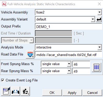

3} yes it's a full vehicle model of the FSAE 2018 template but when I try to run the base fsae 2018 model to determine static vehicle characteristics i get the following error

(1) look in help for the options with your suspension template.
(2) If you know the sprung mass at one axle then the ride frequency is just 1/2/pi*sqrt(wheelrate*2/SM), get wheelrate from the vertical test
(3) Looks like the model didn't build. What files are in your working folder?
