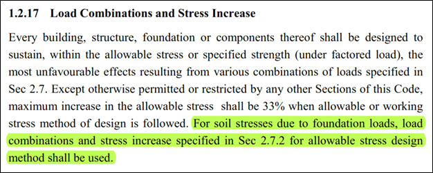

Our code allows the green load combinations for shallow foundations, also allows 33% in soil bearing capacity.
But for deep foundation, it doesn't explicitly say anything. But somewhere it said to use the above listed ASCE-07 combinations. So I became confused.
So my conclusion is:
The ASD load combinations have to be used for deep foundations but soil bearing capacity overstressing is not allowed, and green load combinations can be used for shallow foundations with 33% overstress.
