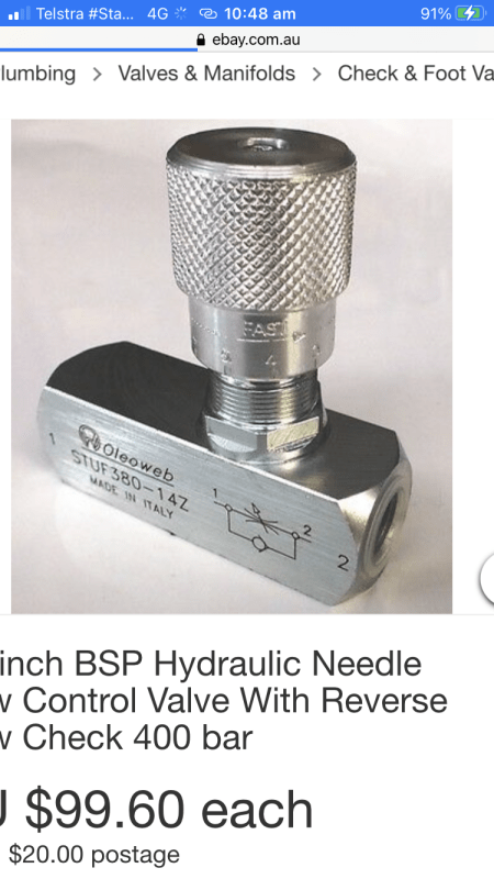

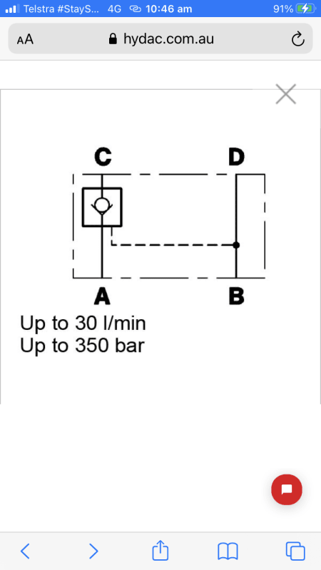

Hi.
I’m installing a hydraulic thumb on a 22 tonne excavator running a 1200 stroke cylinder with 70mm rod, 120mm barrel. I need to fit an inline needle flow control valve with unrestricted reverse flow and also a single acting pilot operated check valve. Reason being is that I have too much flow at 30 LPM and pressure relief set at 2000psi. I need to reduce the flow but have unrestricted reverse flow to avoid pressure intensification in the instance the cylinder is pushed back by the excavator bucket. The check valve is to stop cylinder creep but can only be single acting for the same reason that if the bucket pushes the thumb back theres nothing restricting the thumb cylinder retracting hence avoiding bending the rod.
My question is, is there a valve that serves both of these functions in the market?
I’m not at the machine but from memory it was 1/2 thread or at most 3/4.
 https://files.engineering.com/getfile.aspx?folder=c469cec8-98b5-4dd5-b363-ce7b57bcc7d8&file=8843E3C0-DBC1-4D22-930E-7B17403F04CA.jpeg
These are some examples.
